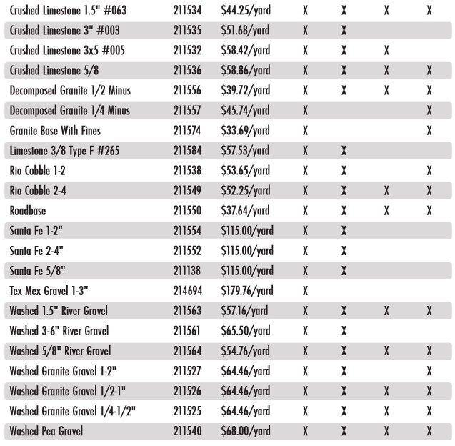

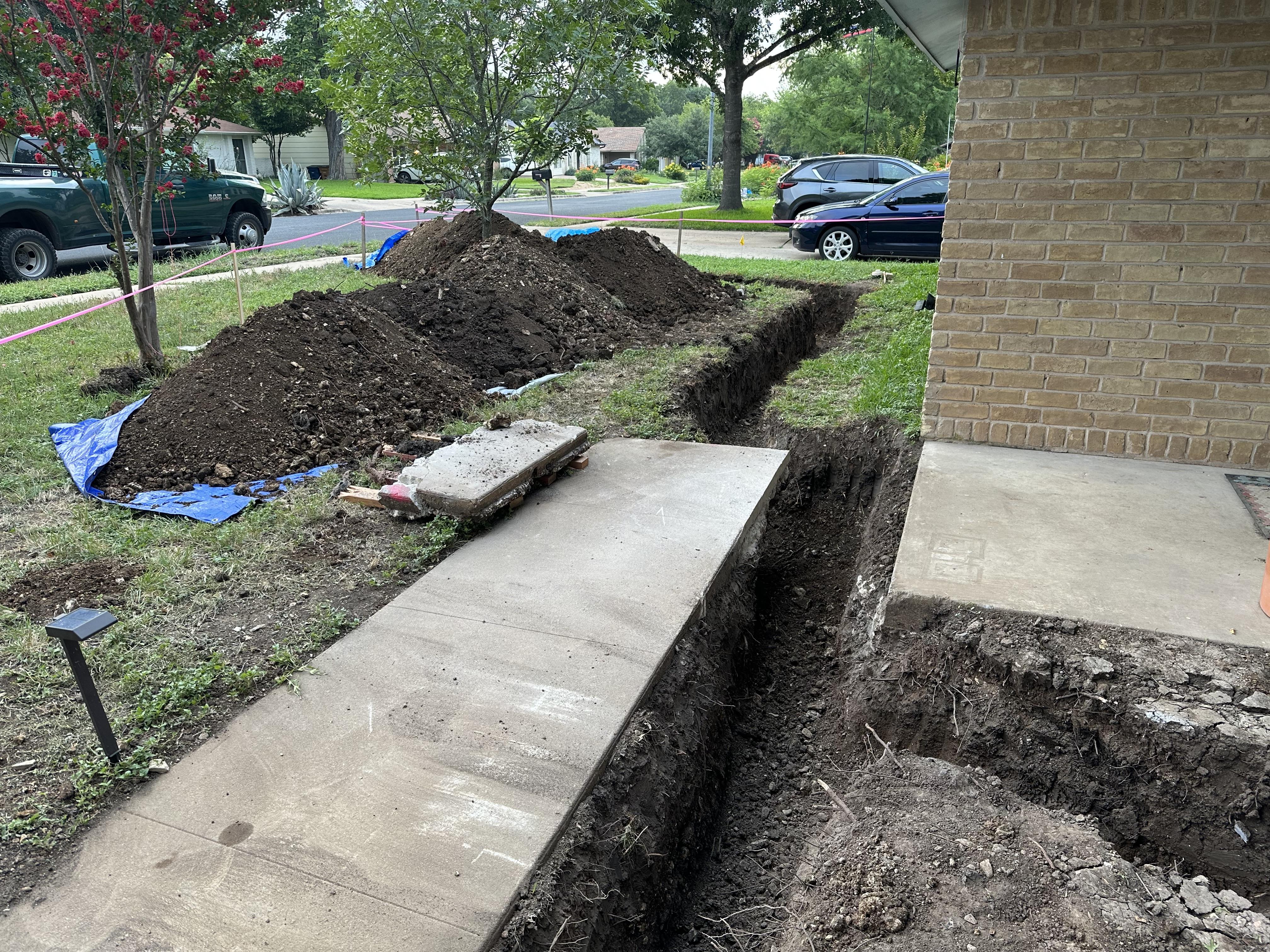

I am running a new sewer line in my front yard. I've trenched 60' and now need to add some bedding material for the 4" pipe. Locally I can get sand, gravel, decomposed granite, pea gravel, and road base. Any reason to use one over the other?
The existing soil is 4-5 inches of top soil, then 20 inches of very sticky and heavy clay. A little bit of limestone towards the bottom of the trench.

Id probebly use what is there. but a foot of sand be nice. A side note , Id probebly turn with the sewer just past the end of walkway with a 22 or 45 as it looks like a 90 you have Id definately put a clean out in yard.

You have a sharp eye! That 90 at the end of the sidewalk is mostly due to the excavator bucket, the plan is to run the sewer line on a 45 underneath the remaining bit of sidewalk. I'll have to sketch my proposed clean out locations, and make sure I'm doing that right. They are required every 135 degrees of change, right?

Reached out to my inspector, they had no preference on the bedding material, said native soil, sand, or gravel are all fine, just can't have any large rocks. I am leaning towards the decomposed granite 1/4 minus. Would the gravel benefit from being compacted with a jumping jack or similar?

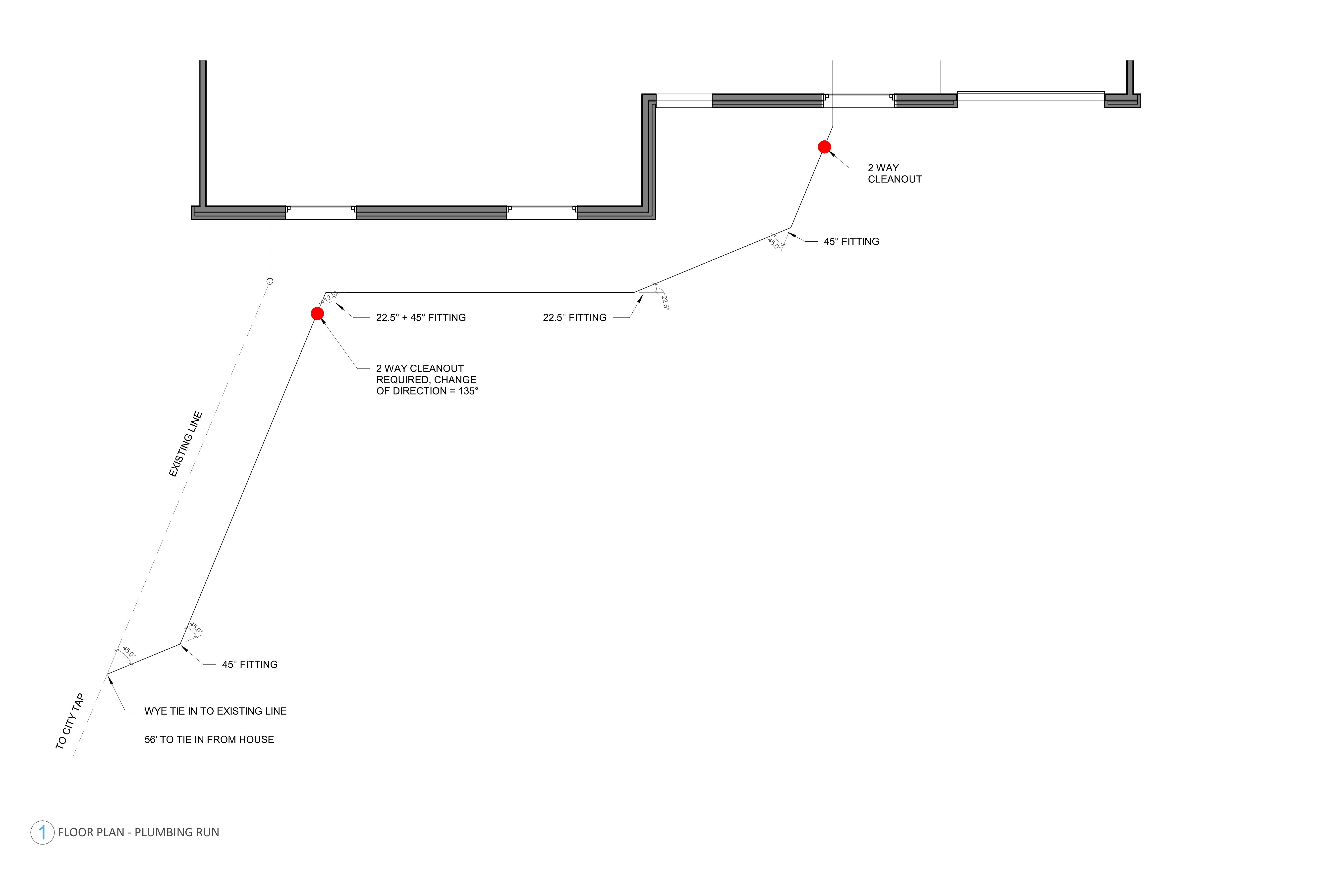

The image below shows the two cleanouts I have planned, indicated by red dots. Is the second cleanout necessary? My fittings add up to 135°, so I think it is. The pipe jogs to avoid a tree in the middle of the yard.

That small of gravel will compact about 3%. If you're placing it on undisturbed soil then you could accomplish that with a tamper or plate compactor. A jumping jack will disturb the gravel as you move from my experience. And I believe you need at least a foot of material over the top of your pipe before using a mechanical compactor on top of it.
You will never regret having extra cleanouts installed in a sewer.

Paul , the clean out next to the 90 I do a little differant instead of the 90 I put a combi on its side and put the 90 on the uphill side pointed up for cleanout. it has advantage being a little closer to the house. I just think its a better way its how I always do it its usually the way I see it drawn on isometrics or plans .
