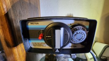

I should have mentioned it's the mechanical metered

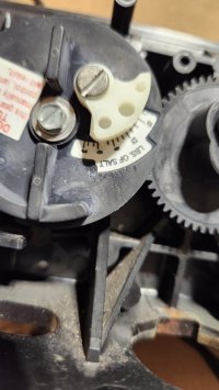

This is a pic of my old powerhead salt pound setting. I guess I should also ask, is it okay to leave it on or should I bypass it. Currently have no salty water that looks almost normal except for more bubbles than usual.
Since you stated '5600 metered' but didn't mention SXT (digital controller), and as the measurement sticker is missing, I assumed a mechanical (Econominder) control valve.
I had initially suspected your new controller may not have been equipped with a brine cam gear, leading me to speculate the controller may have been configured for an alternate use, but I see a brine cam gear and cam is actually present, but is only missing the calibration label.
As you did not replace the valve, the same BLFC flow restrictor continues to be utilized so the same Lbs. range label will continue to be appropriate. Perhaps you can contact the supplier that supplied your new controller, to request sending a new label printed with the exact same range as installed on your old controller.
You didn't specify the total capacity for your softener or the number of gallons programmed, or raw water hardness. I see the salt setting on the old controller was programmed for only slightly more that 6lbs salt to be dissolved per cycle, which is less than usually recommended unless the softener is equipped with only 3/4 cubic feet of resin (24,000 grains total capacity).

I took the power head back off so I could compare better, the new unit salt setting is not very accessible. I determined it was using around 11 lbs of salt on setting. I changed it to as close to 6 as I can get without the sticker (very close).
Would the prev setting of 11 lbs of salt cause the issues I'm seeing with my water?
