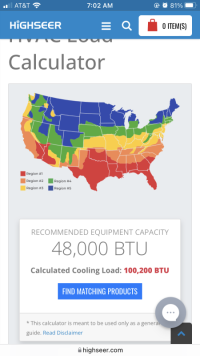

I am not an expert on heating load. After googling and using a crude calculator it said I should require 48,000 BTU. I entered square footage, average amount of windows, average insulation, ceiling height, region (blue) and a couple others.
Need to know the longest loop length. Are there lengths written on them anywhere?

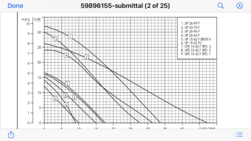

Unfortunately there arnt any markings, writing or indicators of tube length. Seeing as this is all buried in concrete I don’t see any way or finding this information out. I did realize the pex size is 5/8” (not 3/4” as I mentioned earlier). The upper pump is a Grundfros - one speed and the lower pump is a Steibel Eltron - 3speed (set on speed three). I found the pump curve chart for the Grundfros (which is discontinued) which I believe shows this pump to be inadequate. Pictures and chart are attached below.

Fitter30
4,758
917
Peace valley missouri
That pump curve is for 9 different pumps. Need the model numbers. How are you measuring the pex od? There is a lot of difference between 1/2, 5/8, 3/4 loop maximum is 300', 400', 500'.

I have found another pump curve chart with just the pump I have. Grundfros UP 15-42 F. As for pex size, I found factory applied writing on the tubes stating the pex is 5/8”.
