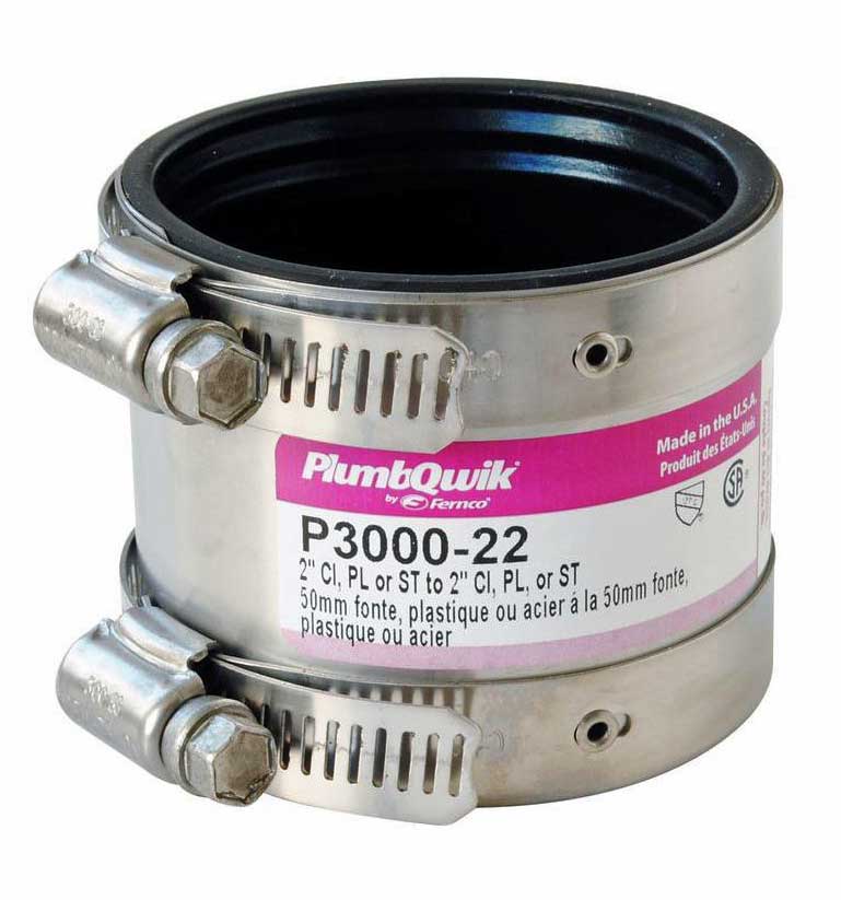

BTW, the underground rubber coupling I have on hand has no internal stop, while a standard solvent weld coupling has a stop. So I think that would be an 1/8" difference if you end up switching, which you could accommodate in a number ways: cut your new pipe 1/8" shorter when you swap couplings, get a repair PVC coupling without a stop (then you need to mark each pipe to ensure the repair coupling is centered over the joint), etc.

I've used couplings like that below grade in the past, but I found out this year that they are not rated for underground use. Of course, if you don't bury the rubber coupling in soil, maybe it's not underground. : - ) That one has a 1/8" stop, so it would make it easy to swap out with a solvent coupling.

never heard that a cast iron to plastic or pl to pl cant be used underground . but never looked into it.
Yeah, I was surprised to learn that.
If you look at https://www.fernco.com/plumbing/shielded-couplings/proflex-couplings for example, the top paragraph says "for above-ground applications." And the approval listed is ASTM C1460, which is titled "Standard Specification for Shielded Transition Couplings for Use with Dissimilar DWV Pipe and Fittings Above Ground"
In contrast, https://www.fernco.com/products/flexible-couplings/stock-couplings says the unshielded rubber couplings are listed to ASTM C1173, which is titled "Standard Specification for Flexible Transition Couplings for Underground Piping Systems". If you want a shielded underground coupling, there's https://www.fernco.com/plumbing/shielded-couplings/strong-back-rc-couplings which are still 4" long.
