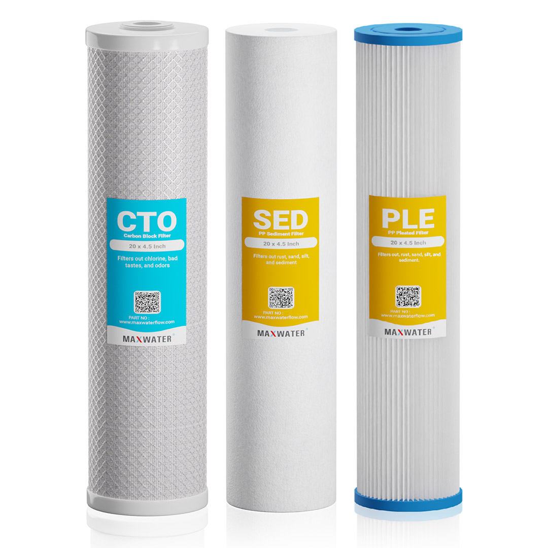

Hello,
I need to install my following 2.5 cubic feet Softener.
A friend of mine and an another plumber suggested to put a filter before softener. Although the plumber advised to just put a single sediment filter , my friend is advising to put the Three stage whole house filter system as mentioned in below two links
Housing - https://www.aquatell.ca/products/three-stage-20-big-blue-filter-housing
Filters that will go in these housings are - 1) A washable 10 micron pleated filter 2) A cartridge 5 micron sediment filter 3) A Carbon block filter
My goal is to catch sediments in order to extend life of my softener resin bed.
My worry is 3 filter system will reduce flow rate for back-washing of my 2,5 cubic feet softener. From internet I did some rough calculation that I need 10 GPM flow rate for good back-washing.
I am on Well water . My connection from Pressure tank into 3 stage filters and then into softener will all be 1 inch.
What do you suggest ? Do I need these three filters ? My Well water has no chlorine but it has smell of sulphur. After the output of filter system , I will be doing a T and give one line to my kitchen cold water . The other line will go to the softener. That way kitchen sink will get not softened water.
What will my softener gain by getting a Carbon block filtered water ?
The filter website do not describe any flow rate related information. I do not want to take this big project before knowing if this could harm the water flow for my big softener's back-washing or to my house bathrooms etc ?

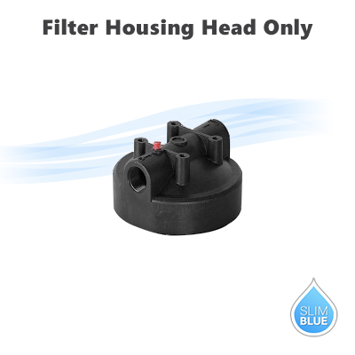

While I am yet to make a final decision, I am tending towards a non Pentek 3 stage filter.
I get that pentek housings are original but this another one is offering built it hole in the top of the housing for pressure gauges.
One question, It comes with the housing head with Brass port v/s the PVC port. Is anyone has nay experience with such port.
here is a link
Seems like they added a brass ring in the port. Will it add strength? my fitting will be Male Brass fitting. Can this cause andditonal cause of water leakage because the PVC port will be one piece v/s seems like they added a brass ring and the space between the brass ring and housing head hole can leak overtime. Should I avoid this brass port?

Carbon block filter that pass the water long-ways are higher pressure loss filters. I would not put that in front of the softener, but I am thinking that could be good for at least some of the water after the softener. I am thinking kitchen drinking water. Not sure about the water heater. I would think not.
I ordered 3 Pentair Big Blue 20x4.5 housings in front of my softener. I then decided to put a backwashing iron+H2S filter in front of that. I had already bought the bracket and filters, and went ahead and had those hooked up too. I am keeping the first housing empty.

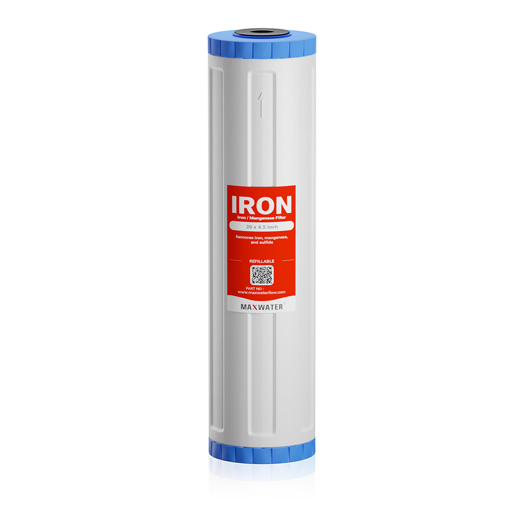

By the way , the same company that offers the housing and filter also sells following cartridge for iron magnesium and H2S. It goes into the middle houseing of the 3 stages. Do you think its worthwhile to try or just a marketing gimmick not expected to be working.

Regarding that 20x4.5 filter cartridge, generally those are going to have limited life. So maybe good for a camping trailer over a weekend. But for a house, you usually would want a backwashing filter.
