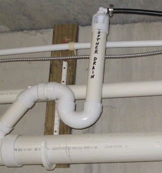

Hopefully the picture attaches below. We’re trying to install a new water softener and the house was pre-plumbed for it. The water loop is obvious and not an issue but the drain line has me concerned. I blew into it and heard/felt it blow freely somewhere (there’s no outside drain end point on the house for it, just the 2 AC drains and water heater dump drains). I added a section of hose and primed the line to see if it would drain.
I was able to get about cups of water into it before the water filled up the upturned hose and stopped draining via gravity. Is this definitely the brine drain for the softener? I don’t know what else it could be for, but I also don’t want to flood the interior wall at 2am during the regen phase.

Where is the softener located in the floor plan? Is there any possibility the known drains are shared with this one? When the hose tops out with the water poured in it, can you blow the water out? Hook up a Shop-Vac or similar to do the blowing, and see if there's air coming out anywhere at all. Are you on a sewer or septic system? I would first try to contact the builder for information before I start removing drywall, but that's a likely path.

The softener drain is supposed to be attached to your DWV system via an air gap. It's hard to believe they did that and buried it behind drywall.
Please keep us posted on what you find.
Common set up:
They have combined washer/water softener air gaps. Your solution might be to run your softener drain through the wall and into the washer drain: https://www.freshwatersystems.com/p...MI3sq0mbuO4AIVC4hpCh1qJQHdEAQYASABEgJXLvD_BwE

Looking at your picture, that trap is amount the amount of water I poured in before it started backing up. But the water coloumn I created should have pushed out the same amount on the other side. I REALLY don’t want to open the drywall (my wife would just love that) but I might have to. :(
