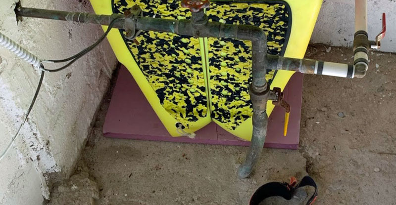

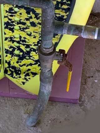

Looking at a house to buy and was wondering if this looked like a lead water line coming up out of the floor. Thanks for any help with this

Lead services are still in use from 70 +- years ago. Why would you wipe a joint between hard and soft copper. The egg shaped joint is what makes me think it is lead.

That looks like a copper bell joint on the end of soft copper to me too... a simple scrape with a knife will tell which is which. Lead will be lead color while copper will be... copper color
