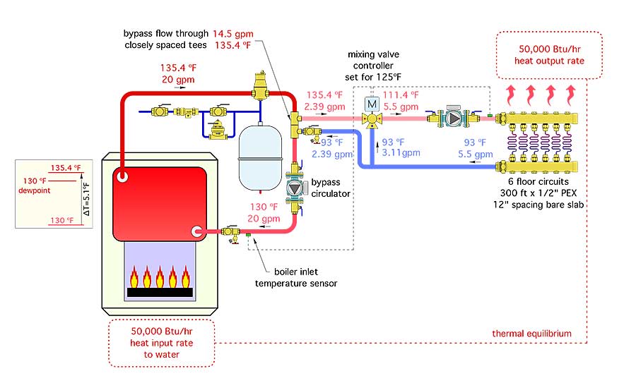

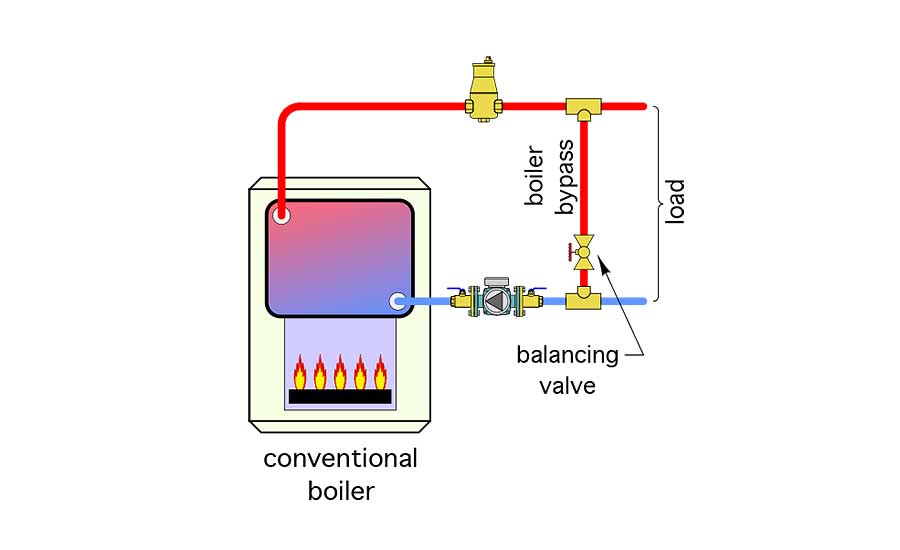

The most important place to measure is on the return plumbing where it enters the boiler. A properly designed radiant floor system with a cast iron boiler will have a bypass branch mixing direct boiler output with the return water just before it enters the boiler to mitigate condensation risk. Any measurement point on the system side of the return path from that branch connection will read lower than what the boiler is actually receiving.
On p.11 of the XEB series manual they specify a minimum entering water temp of 130F, and in Figure 6 show a rudimentary drawing of one type of bypass branch referred to as a "boiler bypass", which is one of the more appropriate solutions for your low-temp radiation system. Take a look at the near-boiler plumbing and sketch it out. A pump located inside the bypass loop pumping toward the branch point to the radiation (as in Figure 6 of the manual) is equivalent to being inside the bypass loop pumping toward the boiler, with the inlet to the pump pulling from the other branch point as shown here:
There are other configurations where the pump is on the radiation side of the branch, which behaves somewhat differently, yet still provides some protection.
An even safer approach is to use primary/secondary piping, with a second pump to drive the bypass branch, using closely spaced tees as the point of hydraulic separation between the low temp radiation flows and the higher temp boiler flows:
See if your boiler installation has any similar features.
