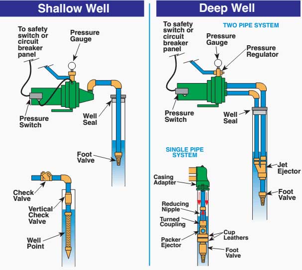

I bought a cabin that had a buried wellhead. The cabin and well have set dormant for over 10 years. The well sits next to a river (75'-100' from the river bank).
It's a two-line system and it will only pressure up to 25-30 lbs and of course, the pump won't shut off. I'm thinking of a clogged injector at the bottom of the well.
I have dug up the well and it has a metal cap and covered up with rubber before it was buried.
The water is cloudy that is being pumped up. I'm thinking either groundwater is coming in through the top cap or sediment has built up at the bottom and is sucking dirt. Once I pull up the pipe I can check the water level and depth and see if it's sucking off the bottom and adjust the depth of the strainer/foot valve.
I have bought a new plastic/rubber seal for the wellhead and don't plan on burring it, but have an access tube and cover installed for now.
Can the injector be cleaned or unclogged or can I buy a new one? Are they specific to the pump?
Any other suggestion or advice would be greatly appreciated.

Any idea on the well depth and static water level? Sitting ten years I'm suspecting as you have that the jet is clogged up with rust, dirt or debris. You may need to pull it all out and check the foot valve. It also could be jammed up. You may also want to pour in a gallon of bleach down the well and let it set a while to help sanitize it.
I have never done anything with any jet pump, which includes a 2-pipe jet pump as you have. I have read various things.
But it is my understanding that they can be cleaned/unclogged or you could buy a new one. They are somewhat specific to the pump in that they differ according with how far the water needs to get lifted and how powerful the pump is.
I would undo the pipe from the house side of the elbows, because the elbows are helping to keep the drop pipes etc from falling.
For putting the elbows back into the poly pipe you will probably have to heat the piping. Usually boiling water is recommended for those less experienced, because damage can be done with a flame if you are not practiced.
While you have things pulled, you may want to replace the foot valve. A foot valve is a check valve with an input screen combined. The symptoms of a bad foot valve would usually be loss of pressure when no water is being used and the pump is off. You don't seem to have that symptom. I don't know whether or not it is good to replace those preventively. Menards has some well stuff including foot valves.

Thank you. Yes I have pulled and cleaned the ejector. It was terribly rusty, clogged and a lot of build up all over it. I have it ready to put back together my next trip to the cabin. I'm sure this will fix the pressure problem.
My next concern is the condition of the well and water itself as described above. It needs a flushing, cleaning and possibly a liner. Thanks

Finally got around to dropping the cleaned up ejector and new well pipe down the well. I just set up temporary pump to flush out the well. You can see from the pictures what it looked like I no the beginning and what I’m get now. I dropped the foot valve down 70’ ( bottom of well is 80’). Previous foot valve was at 37’? It seems like I’m only getting 3 gallons a minute straight off the 3/4 hp pump. After turning the pump off, the well recovers to static level in 15 minutes. While it’s pumping, I can look down with a flashlight and still see water, but I don’t know the level? I never run out of water. Do I need a stronger pump?

Try holding your hand over that discharging water. Does the flow increase?

With the right ejector a 3/4 is only going to do about 6 GPM from 70' anyway. Holding your hand over the water may not be enough. Do you have a pressure regulator or back pressure valve as shown in the picture above. Need to hold some water back with a back pressure valve and it will make the ejector at the bottom stronger and push up more water.
