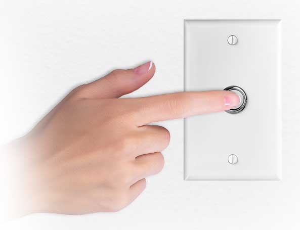

still provide hot water recirc with less gas usage?
You may want to consider the Navien Hot Button accessory. Instead of scheduling continuous recirculation every day for 18 hours in case someone may be home and might want some hot water, a hot button located in each bathroom, kitchen, laundry etc will provide an easy and convenient method to activate circulation on demand such as when entering the bathroom or loading the clothes washer.
Once activated, the pump will only operate for the brief time required to circulate hot water to the most distant fixture.
Recirculation will not be limited to a set schedule and because each run will be brief, the demand option will provide the full benefit of recirculation while offering the most flexibility and fuel savings.
https://www.navieninc.com/accessories/hotbutton

PlumbNuts, I read the manual you linked to but still didn't see anything regarding return line sampling or recirc differential temp mentioned in the other threads. Maybe I missed it.
I've looked into the HotButton but it's not for me. I reminds me of my old 97 F-250 pickup that I sold last year. I had that truck so modified for performance that any other person would have a hard time working on it. I sold it last year and bought a used 2016 F-350 that is bone stock and plan to keep it that way. My interests have changed and moved on from tinkering on trucks to raising a family. I just need stuff to work when it's supposed to.
The hot water recirc we have is awesome. I don't have to wait for hot water and I don't have to think about it, it just works. (That's a lie, I think about it all the time.) If I'm going to push a button and wait for the hot water to circulate, why wouldn't I just open the hot tap and wait for the hot water to arrive as we've done for years? Then I need a button at the kitchen sink, the laundry sink, etc. It begins to look like my modified F-250. I have other things to think about.
So my thought was to eliminate recirculation 25% of the time (6 hrs) and save some propane while not changing ease of use.
(If fossil fuel prices rise significantly over the next four years I"ll be back here asking you how to install the HotButton :D)
When entering the bathroom or preparing to wash dishes or laundry, seldom will hot water be needed immediately. If the pump is activated when someone enters the room, hot water will usually have arrived by the time it is needed.
I know some have utilized a motion sensor to replace the button to make activation automatc. In this manner, unlike a set schedule, recirculation will only run when someone is actually present and within the room where hit water is likely to be utilized. A daily 18 hour run schedule will utilize a substantial quantity of fuel maintaining the temp of the loop when no one maybe home and even while someone maybe home but not requiring water.
While you may plan to utilize the NaviLink App to control the circulation function, that will typically become another unconvienient task to be forgotten.
