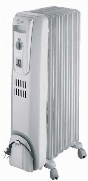

In the mean time, buy yourself a $50 oil-filled electric radiator for auxilliary heat in the room where your husband spends the most time. Cold snaps come and go, but there is no point to suffering.
These are far preferable to those with fans or glowing orange elements, since the surface temps are reasonably well bounded making it harder to burn your house down with it. (Don't drape your soaked winter jacket over it to dry though.) Any of the building materials box stores or even Target/Wal-Mart type outlets will have a few models to choose from. As long as you limit it to 1500 watts most house wiring can handle it without a problem.
1500 watts in electricity terms translates to about 5000 BTU/hour in space heating capacity terms. That is more than enough supplemental heat to keep any room that is lagging in temperature up to temp while you figure out your boiler & radiation and house insulation/air-tightness issues.
