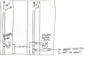

My family and I moved from SW Wisconsin to the Olympic Peninsula of Washington about 3 years ago. We are building our house ourselves and are about 70% done. It's time for plumbing. The footprint here is pretty small, one bathroom on the ground floor with a shower, toilet, sink, then a kitchen sink, dishwasher, and washer on the opposite wall. There's pipes in the slab done by a pro, and septic is done and hooked up and water is in the house in the shower stubb wall. Here's some drawings that will hopefully make some of what I'm intending to do clear. What I don't have shown in the drawings are the vents, as I'm unsure about this. If my vents can be 1.5", then I plan to tie the pairs together in the walls, and then tie those together in the ceiling above the bathroom and bring them to a main stack to go up the outer wall and out the roof. The pipes for the washer will not be in the wall, as we changed the location of the washer from sharing the bathroom wall to 6' away from the wall and I can't run 2" pipe inside that wall.

Some drawings to hopefully help make things clear.

Jeff H Young
9,803
2,481
92346
w/m wet vented with k/s might be issue Ive done it with 2 inch b ut dosent meet code I think 3 inch works or a 2 inch that isnt wet vented.
2 inch vent below slab wont work on a dry vent but could be a wet vent going to shower, in which case the kitchen and w/m need to connect to main down stream of the wet vented fixtures
Pipe Dream
9
Washington State
Thank you Jeff, I responded to you also in my other post that is only about venting. I think I follow what you're saying here. I was thinking of a 2" dry vent for the w/m and k/s. I think your second idea could work but having everything in the bathroom downstream might break the deal. I'm having trouble understanding why I can't take all the pipes that stand out of the slab and take them all up into the ceiling and bring them together eventually into one 3" pipe out the roof and have adequate dry venting for everything, but clearly I don't know enough yet. I may end up hiring out the vents and roughing in the drains.

Jeff H Young
9,803
2,481
92346
This changed a lot I didnt know this was poured in concrete use the pipe farthest from the toilet for the w/m and kitchen sink and the one close to toilet for the lav to be legal . also pictures werent viewable befor some times people post pic but they dont show for awhile
