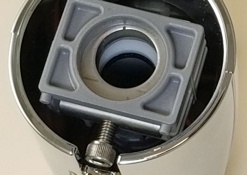

Need to replace tub spout adapter line.

I mistakenly over tightened my set screw on tub spout now need to replace the short copper pipe to it. I have PEX connected to it now, to valves and shower head. I have access to the back. Am I better off heating from the front or rear? Either way there's wood. I'll use a pie plate to save some scorching. Any ideas would be great. Thanks .

Also that white piece got stuck on, i did get it back off.

Get rid of what you have and install a new Moen tub spout that is a copper slip spout.
That's what I was using but i tightened it then dummy me i turned it and scored around the whole pipe, now water leaks back towards wall. And pipes squished a bit. My bad.

I am not a plumber. I have done a grand total of 7 solder joints that are in use in my house. I did a lot of practice before I did those.
Terry has a ton of experience, so his suggestion is likely your best bet.
If you are going to de-solder:
- Soak the surrounding wood with water. You don’t want to burn the house down.
- Wrap the fitting going into the shower valve with a damp rag to keep everything else cool.
- If you are not used to soldering, practice. If you solder a closed loop to a boiler drain, you can hook your work up to a garden hose to make sure your joints are good.

Should i also remove the cartridges as to not accidentally melt the rubber gaskets in side from all the heat?

Honestly, I am not sure. If you get the valve that hot, I would also be worried about damaging the PEX. There might be merit in keeping the water in it to keep it cool. Like I said, my experience in this is limited. I would see what the pros say.
