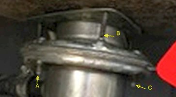

Are there 4 long hanger screws? Two that I see come down lower than the nearest one. I presume there is a 4th one on the far side of the bucket photo.
Anyway, I would think those screws would have pretty much the same amount sticking down.
Or are there 3 hanger screws, and that thing I thought was a screw is something else.
I labeled A, B, and C.

There are three bolts between the sink strainer and the flange, then there are three bolts (the ones protruding downward) is to mate the disposal to the flange via three keyholes. I guess this model is old so they don't use the modern locking mechanism. I just now found the part diagram online. There are two type of gaskets (2008, 2009) between the flange and the body of the disposal but apparently they're discontinued. I guess i have to buy a new disposal.

I don't see anything labeled "2"? But to answer your earlier post, "B" would be part # 2006 is the bolt to keep the flange tight to the body of the drain assembly(three bolts total). "A" and "C" have the same part # as "B" which is 2006 but bolted on the main body of the disposal then slide into the three keyholes on the flange (3 bolts total). If you look at the part diagram part # 2005, there are three keyholes and three round holes, round holes are for part "B" bolt upward pressed against part 2007 to hold it tight in place and keyholes are for part "A" and "C" to slide lock into place.

Got it. Yes, I meant B.
Do you think 2009 might be the seal? You might want to phone the maker. They may have some tips or a way to get a new seal. Is this a new install?

I decided to buy a new disposal. As much as I don't like to throw thing away when its still working but it takes too much time at this point trying to obtain that gasket. The maker is GE Disposall GFC290-01.
