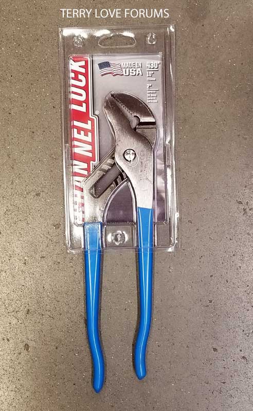

That looks like a PEX connection. They soldered a male adapter straight into the spigot. You're not going to be able to unthread that because they didn't thread a fitting onto the spigot, that's part of the spigot if someone wants to use a female adapter with it.
You might be able to remove the split side by heating up the copper near the knurled joint. But you run the risk of damaging the pex connection. My recommendation would be to cut the pex and install a new spigot on that.

I had been thinking they used of one of these, but I was wrong, because of no hex.
