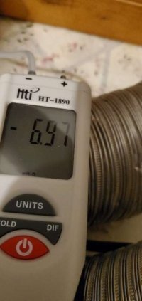

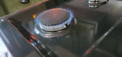

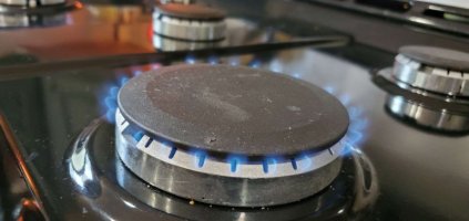

Update:
-I checked dryer and range line at cutoff valve. Removed flex hose. Both around 7". Pic.
-Moved back to kitchen. Preheated Bake to 350. 9 min. Much quicker.
-Burners higher but still look low to me. Someone said that's how the new ranges are designed. Pic.
-Could have all my flipping around knocked off some scale? And is this really fixed? Very unsatisfying ending here.

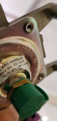

This is the old regulator they took out. What does 1/2 PSI mean? Max or required? That's like 14" right?

That regulator with the green cap has what seems to me to be an odd paper label: "NAT 5 WC LP 10 WC"
If that same regulator can be used for both, I would think there would also have to be an orifice change, since LP has more BTU at a given pressure. Either that, or the burner just puts outputs less BTU on NG.
I am not a pro, and I may be missing something.
It just means the regulator can handle either and its meant to give it 5" wc for nat gas and 10" for lp. Which would require springs adjustment when switched.
Yes it's 14" max which is about 1/2 psi

My thought was that the regulator would take either down to 3.5 WC, and the orifice was chosen as a compromise.
I did not find the difference between LP and NG BTUs at the same pressure. It is commonly stated that a cuft of propane has over twice the BTU of a cuft of natural gas. But I suspect the propane is at 11 inch WC and the natural gas is at 6 WC..

If you use LP, you take out the brass 'nozzle' and flip it so the LP arrow is pointing in. Reverse for NG. Must adjust some kind of spring.

the ones I seen didnt have a nozzle that needed flipping. they have a rod that sets the pressure on a diaprahm you fip that and it changes the length and spring tension hence pressure change.
