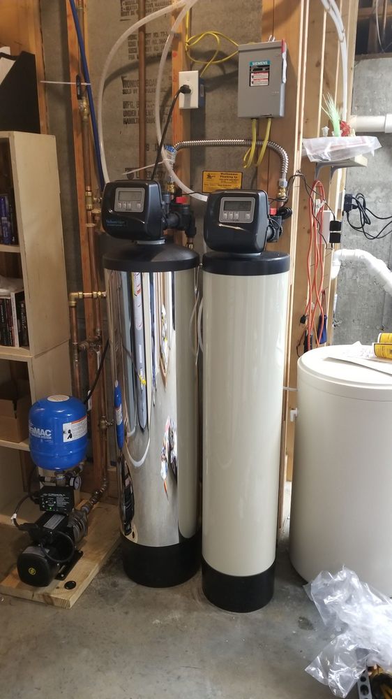

I have been encouraging people who have a house piped in wirsbo pex or any kind of pex to
consider installing a 2 cubic foot backwashing carbon filter to take out the chlormines in the city water
and extend the life of their pex plumbing system--
If that's the reason the Uponor is failing. Is it? Maybe. It's as good a guess as we have right now, but there's no definitive scientific study that concluded what the failure mechanism of Uponor pipe is, and Uponor certainly isn't saying (assuming they even know themselves).
But as you say, there's no downside to removing the chorine/chloromine from the water, so why not? If you've already got Uponor, a filter makes sense, but I would also remove any recycling hot water system and add a PRV as well as Uponor pipe also doesn't seem to like hot water or high(ish) pressure.

Found my first. Got a call from a contractor I work with that he had a leak in his house. Work had been done by a guy that worked for a company I worked for, but he was doing this job as a side project.
Navien 240A with recirc loop, with recently failing oversized expansion tank coupled with a Scala 2 pressure pump just to the left of this photo where the hot pipe below (red and blue mixed) and cold on top (blue / clear mixed ) connect.
Split was on the Hot side where that Hot blue pipe comes out of the stud from the left on the horizontal connection to the elbow.
