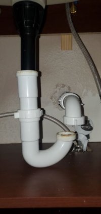

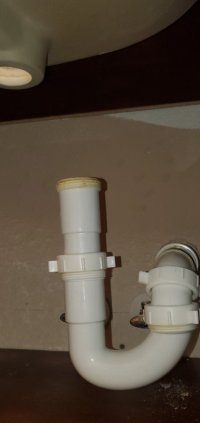

Photos attached.
I went to the store and bought two sets of supplies - one is the double slip joint elbow I referenced above, the other is a threaded adapter that screws onto the marvel trap adapter so I can add a regular glued 22.5/45 pvc elbow and then glue another marvel trap adaptor to the other side. Is one way better than another?
Thanks.

I am not familiar with that threaded adapter that screws onto the marvel trap adapter.
Then with a new trap, with a longer trap arm, you bring the U of the trap out farther from the wall, and feed the trap arm into that 45. Experiment as best you can without cutting.
One more thing: how much pipe is between the wall and the existing trap adapter? One thing that could also help is to cut that pipe, and glue on a 45, maybe a street 45. Or get a spigot trap adapter to fit a regular 45. The problem I could see then is the paint on that PVC might make it hard to get the 45 glued on. One more thing... there are also 22.5 degree bends.
Cutting that double bend would mean no new gluing, as long as things work as I envision it.
Maybe your existing trap would fit, but I am thinking it would be too close.
So my thinking would be to get a slip joint 45 cut from that double slip joint piece. I am thinking that

Reach4, it's too close to the wall to really risk cutting it for me.
I am probably using the wrong term but the adapter is just a coupler that I am talking about threading on to the marvel....is really common. Feels too easy so probably wrong. Screw this on my trap adapter and then glue in the 22.5 and then the trap adapter to that again.
Also makes it so you can dismantle it if necessary.

Yes, the ability to undo it if it does not work is good. I think each way we are discussing has that feature.
So maybe cut out a cardboard model of a 45. See how the trap will approach the line. Try swinging the U the other way.
Maybe use a toilet paper core or paper towel core for your trials.
https://www.homedepot.com/p/NIBCO-1...b-x-Spigot-Street-Elbow-C48082HD112/205799554 is a street 22.5, but other sellers have that readily available.
