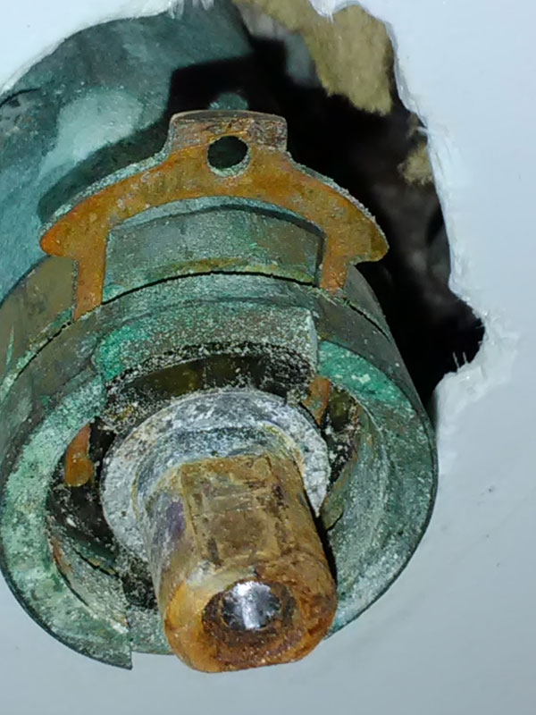

Moen Shower Faucet Removal

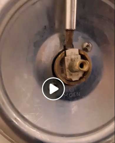

Thanks for your reply. Unfortunately now I have a "real" problem. I went to the hardware store and purchased the replacement cartridge and set about removing the old one. First, the plastic tool that they provided was nowhere near up to the task of removing (or in fact even moving) the old cartridge. So I went back to the hardware store and purchased a Moen Cartridge Removal tool. This worked "better" but in the end it broke off both of the brass tabs of the old cartridge and popped out only the core of the cartridge. So what I have now is the brass encasement of the old cartridge still very much in place. Anyone have advice on how to remove this? I am considering going and purchasing an internal pipe wrench and attempting to remove it with that. Any assistance would be appreciated.

There are several techniques for dealing with you problem:

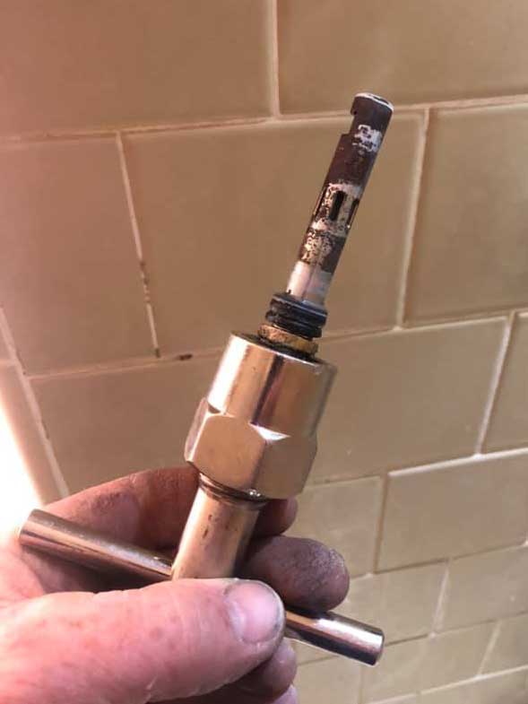

Some cartridge tools ( not the MOEN BRAND tool) have a long stem the same diameter as the inner stem you have removed. On the end is a spring-loaded pin which enters into one of the ports in the cartridge barrel and provides more leverage. It is a one-shot deal: if it fails, you now have the added problem of a tool stuck in your valve.
Many folks successfully use internal pipe wrenches or an easy-out extractor of the appropriate size.
Try spraying into the body some vinegar ; it helps loosen calciium deposits.

I have 4 differrent tools for removing a Moen stem and none are the perfect tool for removing every Moen stem. Recently I heard about inserting a short wooden dowel inside the core and then using a 1/2" bolt tap into the unit to "jack" it out. Sounds like it would work, although I would only have to do so if I did not have my other options.

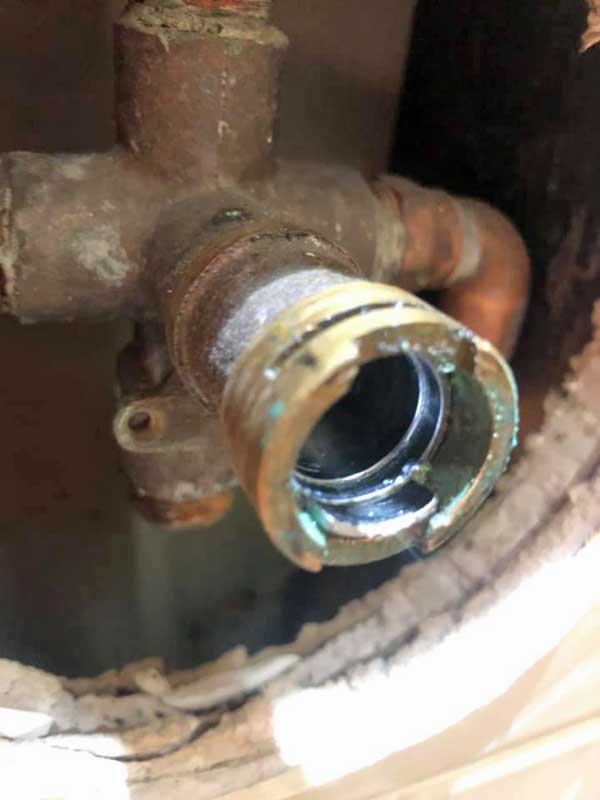

Like Jimbo said once you break off the stem (I did that too) there is another tool shaped like a "T" that you need. It' s basically a handle with a long rod and a spring loaded "catch" on it. You insert it into the brass, outer shaft of the cartridge that is still in there. It has to be maneuvered to catch onto one of the holes in the brass shaft. Once it catches it pulls out. But, depending on how long the cartridge has been in there in may take some mighty tugging!!!! My was in there about 28 years (original from when the house was built) so it was really tough to get out.

I hope you have already solved the problem. Years ago, I had the same issue. I had to call Moen and get a live person to help. I found that I had to first put a small wood dowel in. It was just wide enough to fit loosely and maybe 1 inch or so lone. Do not need to be too exact. Then I used a tap to screw into the brass cartridge until the tap bottomed on the back of the fixture. Since the cartidge is a tube with an open end, i kept screwing the tap in and the cartridge was pulled out by the tap. The tap pushes on the dowel which pushes on the back of the fixture without metal to metal contact. Moen did tell me the exact size of dowel and tap I needed.
As I did not own one and it was night time, I had to put the old parts back overnight so that I could turn house water back on. I bought a cheap tap and die set and did the job quickly. I repeated the repair on all the other shower fixtures as they all wore out. The replacement cartridges are plastic and I have had no trouble getting those out.

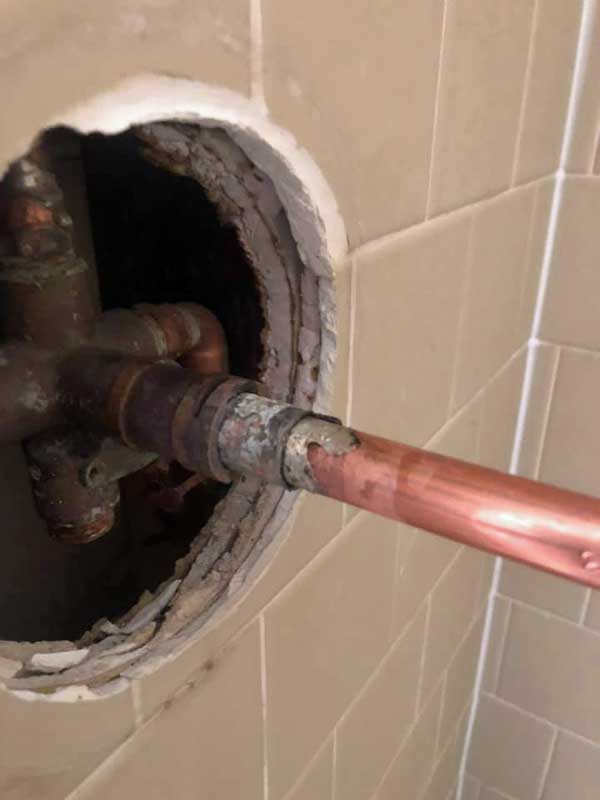

I just did a tear out of my shower wall due to a leaking 27 year old Moen Cartridge - it looks like a fossil...
I'm getting ahead of myself... first, I determined that the faucet was leaking - not hard - then tried to remove the cartridge - VERY HARD. Broke off the brass ears with a homemade removal tool (fashioned from a deep well 13mm socket that I cut big notches in that fit into the housing). Then, trying to pull it out, I ended up pulling out the guts of the cartridge with a slide hammer - so I was left with the brass housing stuck in there. I haven't sweated joints apart or together before so couldn't replace the faucet... So...
I got on the Internet and looked for some tips to remove the guts and didn't see anything that filled me with confidence - afraid to destroy the whole housing... (except I got excited about the above article describing using a dowel stuck in there and tapping threads)
So... I used a 1/2 inch 20 pitch tap and cut threads into it about an inch and a half or so... went to Lowes and looked in the "C" hardened bolt drawer and got a couple different length hardened bolts and a bunch of washers - took it home and screwed it in and it pulled itself right out. It was beautiful. So, I put some grease on the new one... blew some air into the empty housing to clean out the brass shavings - cleaned it out a little with cloth and slid the new one in and aligned it with the plastic tool. The new one has GREAT action and does not leak - I used the danco brand brass replacement and danco brand grease... and will be using cement backer board for the wall and am reusing the old tiles by soaking them in buckets of soapy water. - Hope this post helps someone out there!!

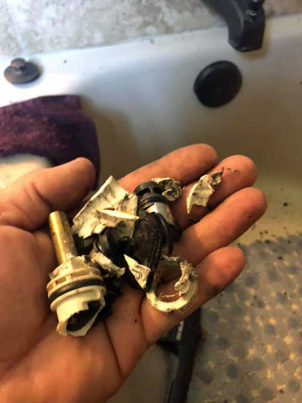

Once the inside of the cartridge is yanked out and the old jacket is left stuck in. I use a 3/8" wooden dowel rod cut to 1 1/2" long insert it into the hole. Then I run a 5/8 tap into the the jacket as it presses on the dowel rod it starts to pull out the stuck jacket.. This only failed on me once , in that case I ended up replacing the whole valve. Question did you remove the horseshoe shaped clip before trying to pull out the cartridge? You may of said it in the other posts but my eyes are getting hazy at this time of day.

Remove the clip first.
I have seen a couple where the customer removed the cartridge without taking the clip out. It very nicely removes the front of the faucet body also. They had used the tap and wood peg method to jack it out.
