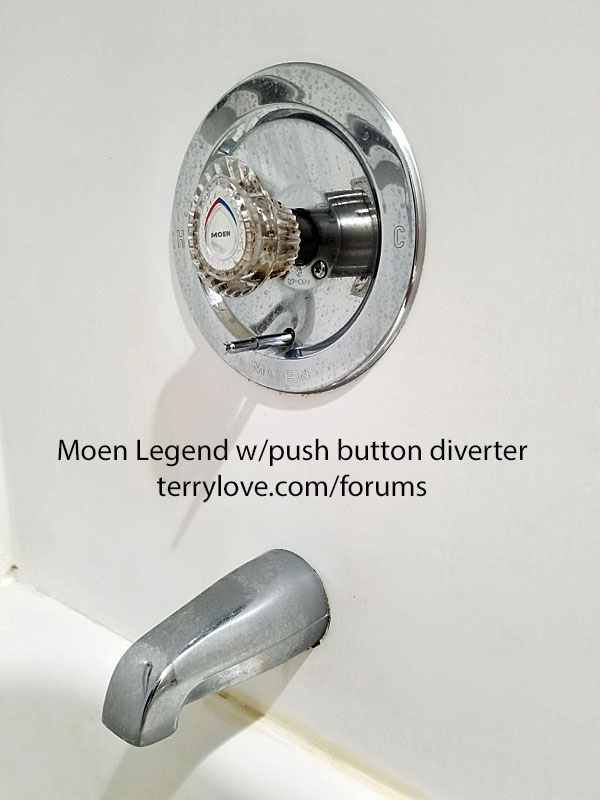

I have a super old Moen Shower Push/Pull Mixing Valve and I need help identifying it.
From another post I found that the valve is a 1200, but I don't know what the push/pull diverter is. Also, I can't seem to find a replacement trim kit that has the hole for the push/pull diverter.
Thank you in advance for your assistance.
3,481
Looks like the Moen 2400. The cartridge can be either the 1200 or the 1225.
The diverter part can also be gotten.
