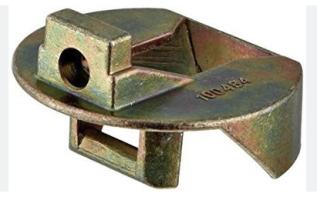

The moen 101099 handle connector is what changes the action of your cartridge from a pull to a lift. This adapter loops round the bar on the 94746 adapter and changes the fulcrum point to the 12 o-clock position and create a lift to the handle.
This might be your missing part. however yours might still be in good shape and reusable.
Good luck.

Thanks! That makes sense... I will try to get the handle off to see if the parts are still usable behind it. I believe my old handle is rusted to the metal piece you show above... probably on the block the screw goes through that fits in the handle. Any advice before I use oscillating tool to cut it up? I tried vinegar yesterday... will try some penetrating oil today...

I appreciate everyone's help here. Took me a while but I was able to use oscillating tool to cut the old handle off. Thought I had every part possible to put it all back together, but three things I never saw in any diagram... the valve had a brass extension and there was a long screw that went through the plastic handle piece above, through the extension and into the valve. This was due to the depth of the long black plastic sleeve that attached to the valve body with two metal straps and that the double metal sleeve threaded on to to hold the main escutcheon plate into place. Never saw any of these in other diagrams... but luckily, the old ones were still usable. Everything works, but even with the set screw fully tightened, the handle seems to wobble side to side a bit... so I am guessing the metal pivot piece underneath is not seated properly. The long screw did not seems to tighten fully into the valve either... so I am wondering if the screw size has changed over the years? or may be i did not have the pivot piece seated right and the screw only had a few threads reaching valve... anyone ever have this issue? Or know of full diagram of all of these valve pieces? All of the ones i see online show that thin metal sleeve with the square bump out at top, not the long plastic tube with dual metal sleeve thread on.
