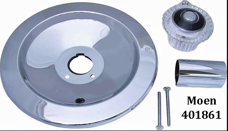

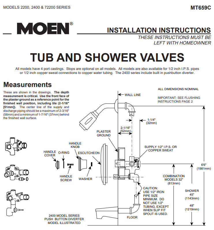

Hi Folks,
Just created a new profile to see if I could some help with an issue me and my wife are having. We are remodeling a bathroom in our older home and stupidly threw away our shower handle plate and hardware as well as the faucet thinking we could replace it with ease. We have learned the hard way that is very much not the case.
Our old shower handle was a Moen with a push diverter. We are trying to figure out what hardware we can now purchase to replace it. Shower valve and diverter pictures attached. We would greatly appreciate some help!

Can the push diverter housing be removed from the main valve?
Long story short, I need to replace the part that the push diverter sits into, but the picture makes it look like it comes as one piec.
