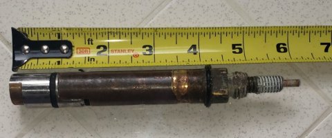

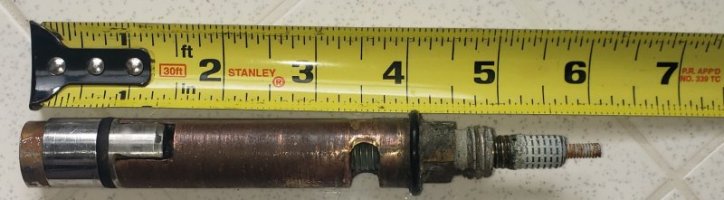

I also have a problem finding out where to parts or identifying what type of mixet valve this is. Can some one help. I'm also having a leaking problem. The volume control is stripped or the valve is not turning off the water completely. I will send some pictures.
