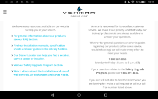

I've got one of the HRVs that has a safety warning where the blower motor bearings fail and the unit catches on fire. The following explains it.
The manufacturer's band-aid fix was to provide the following inline fuse so that it will blow when the motor fails rather than come good for a terrible motor design.
We the end users are on the hook to replace the motor every few years or take it apart frequently and oil the motor bushings. The unit has fragile components so every time I take it apart to oil the motor I end up breaking some other part. It's to the point I dread having to take it apart yet again. This thing is a real POS and time to replace it.

Have u contacted venmar? Sleeve bearings are in most cases not designed to carry axial thrust loads.

To what end? They contacted me and supplied me with that inline fuse.
I contacted Venmar on March 15th and they confirmed that they sent me the inline fuse and considered the case closed. I requested the case be escalated and they reluctantly took my phone number and said level 2 support would call me back. I am still waiting for the call.
