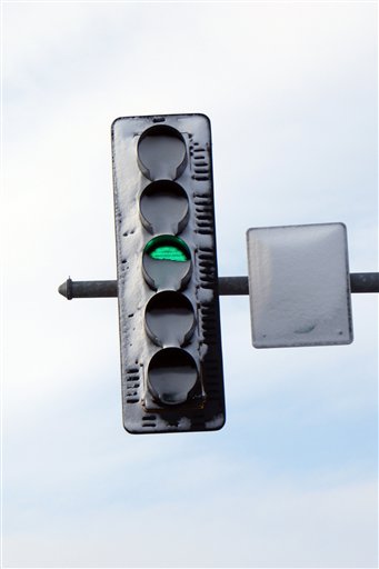

Dead segments are more likely to occur in places that regularly see 100F+ ambient air temperatures, in fixtures that are not well designed for shedding heat. A traffic light is pretty rugged service. But it's also a very high duty-cycle service.
The power savings in traffic lights are HUGE, since with filters the lumens/watt of incandescent traffic lights is under 5, whereas using the unfiltered inherent LED colors the efficiencies are on the order of 20x better. And even with heat related failure, the replacement rate is a tiny fraction of incandescent technology traffic lights, and quite cost-effective on labor and bucket-lift hours time alone.
A bigger issue than hot-climate failure rates is in cold/very-cold snowy places where the LED traffic lights don't generate sufficient heat to be inherently self-defrosting.
