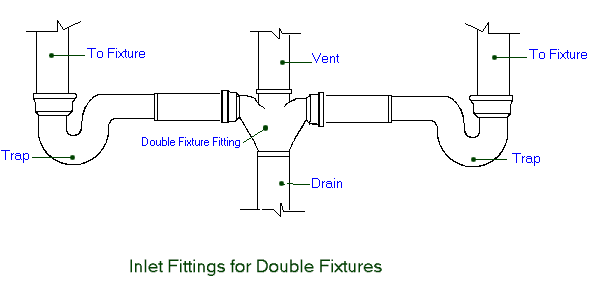

Austin uses UPC. They probably allow AVCs, but maybe not. If they do, you could put a double fixture fitting where you have a tee, and put an AAV at least 4 inchs above that.
To the left and right of the double fixture fitting, I would go to slip drain lines instead of glued, but glued is certainly good. Glued is harder. Those drains plugs at the bottom of your traps don't really contribute. To convert to slip, you would put trap adapters.
The elbow into the wall should be a long sweep elbow. You might be able to unscrew the AAV, and put a snake down there if that elbow clogs. Awkward.

Seems reasonable to me. The conventional arrangement would be this, I think, starting at the wall and going upstream:
Horizontal PVC DWV pipe (trap arm)-> trap adapter -> horizontal tubular pipe (trap arm) -> tubular P-trap -> vertical tubular pipe -> tubular tee with two horiziontal inlets -> tubular horizontal tailpiece (each side) -> tubular 90 elbow (each side) -> tubular vertical tailpiece (each side) -> sink basin (each side).
Or if it fits better, you could put the P-trap under one sink, and use a 45 on the horizontal at the wall to get the trap arm pointed towards that sink. Then your tubular tee would have one inlet vertical, and only the other sink would need the horizontal tail piece.

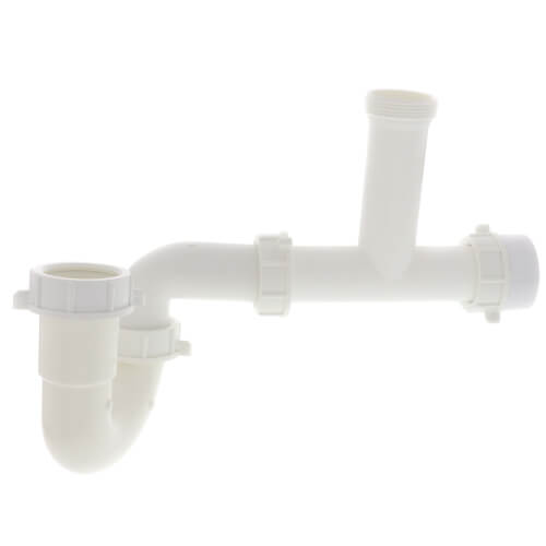

In case you haven't found it, this is a 1-1/2" tubular set up that works for dual sinks on up to 26" centers:
https://www.supplyhouse.com/Sioux-Chief-230-270625104-1-1-2-x-25-Centers-with-Baffle-Tee-White
So with an 1-1/2" extension, and a way to change the top inlets to 1-1/4", it should do what you want. Unless, of course, there's some prohibition on >26" centers that I'm unaware of.
Cheers, Wayne
