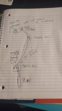

Good afternoon, I am having problems with my irrigation system, I am sharing a 3 horse power pump with my neighbor I am having problems with it and he is not. My pressure goes up to 100 psi and the pressure switch doesn't switch off the pump, when the neighbors irrigation turns on the pressure switch shutdown at 50 psi and turns back on at 30 psi.We have a Franklin deluxe controller box at the river connected to a 30 amp breaker, the breaker is connected to L1 and L2 and from there wires run up hill maybe 175' and they are connected to a pressure switch with a storage tank. Those wires are connected in L2 and SW in the Franklin control box. From the pressure switch it connects to a pump relay, one wire is connected to line and the other goes to load and there's two yellow wires that are connected and run to c and MV on the controller. I don't understand what's wrong, I will appreciate all your help, and thanks.

I am made a quick diagram of how it's connected, my irrigation doesn't turn on if he turns it on unless I turn it on, and then the irrigation starts. I also forgot to mention that one zone never reaches 100 psi it stays at 44 psi, however I have 11 heads in that zone.

I Cannot see how this ever worked. I’ll come up with plan that will require your neighbor to have one. How does the neighbor turn on his side after you turn on yours? The three wire pump going to the Franklin controller makes it more difficult.

If you call CSV, asked if they have any drawings for your set up. Cary, I think is semi retired with a wealth of knowledge, but one pump two homes seems to be more common and I'm sure he has done this before.
With two controllers at each home, the MV leads need to go a maser valve, one for each home. If your home is the furthest from the pump, a master valve would be need on the feed pipe at your home. A MV is nothing more than a regular zone valve.
In my head I have it figured out. The pump would always have power and controlled by the pressure switch alone. When one MV opens pressure drops thus the pressure switch would run the pump. If your zones are large enough so where the pump cannot get to 60 psi, it would run continuously as you want it, however, the CSV would provide a steady pressure to each zone.
Does this make sense for you? I'm not very familiar with Franklin controller, my church has one where the caps went bad, but I have an electrical degree so I know I can figure it out.

I got a rough drawing together. The will allow to leave power to the Franklin controller on at all times. The pump would turn on via the pressure switch connected to the SW and L2 terminals of the Franklin. Each home has an irrigation controller and its own master valve, (1" zone valve recommended). When irrigation is called for the MV lead has 24v ac on it for the duration of the program to keep the master valve open. This will drop the pressure and the pump will turn on.
This set up allow separate control at each home activated by the irrigation controller. I highly recommend the CSV for a steady pressure and Rainbird WiFi controllers. The MV can be anywhere and usually near the irrigation controller. After the pressure switch add a spigot to allow the pump to run without the irrigation system activated.
