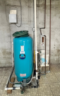

Did some diagnostics, I think I have this mostly worked out.
Turned on 4 faucets, 2 upstairs 2 on main level. Should be about 6gpm.
Watched the pressure and the switch. Went down all the way to ~35psi before clicking on and all the way to ~65psi before clicking off. Took about 15 minutes to build that 30 lbs of pressure and fill the tank again.
Pressure at the taps were "acceptable" throughout the whole range but obviously had a some lack of flow when the tank was depleting without the additional flow from the pump.
I adjusted the range nut by tightening up 2 turns and loosened the lefthand "gain" nut all the way in attempt to restore the pressure switch to 40/60. The result is now 40psi kick on and 65psi kick off. I think this switch needs to be replaced or at least the springs, but like Valveman stated, I think I would rather switch it out for a 50/70 switch. The well tank is at ground level in the basement and with 9ft ceilings, there is like a 25-30ft climb to get to the shower heads.
If anything, I believe I may have too large of a well pressure tank! I think my pump is working fine since it overcame the 6gpm faucet dump quite easily, it just takes forever to bridge a 30psi differential in such a 62gal tank.
The issue of "no-flow" seems to only occur when laundry or another high gpm demand is on while the well pump is off.
As soon as the tank was depleted and the pump kicked on, the wife had adequate pressure to take a shower while doing laundry.
Next Steps:
I have received the CSV1A from CSV. I'm wondering if I should install on my system as-is or reduce my tank size. I like the idea of the small tank from CSV for consistent pressure and flow from my pump, but think that would cause the pump to have a lot more starts and stops throughout the day. Maybe a 10-20 gal tank?
Noticed my well tank tee could probably use replacing...
There is no check valve. I've read conflicting views on this as there is likely a check valve in the system closer to the pump? I don't want to cause water hammer here - I don't have any currently and am enjoying it.
There is some galvanized fittings and pipe about a foot away from the tank before the water hits a spin-down filter and gets distributed to the rest of the house... will replace that.
The valve to drain the tank coming off the tee spins but does not release any water, so needs to be replaced.
As stated, new pressure switch is likely in order.
Thanks again folks. Penny for your thoughts !

From 40psi to 67psi it took 3 min 45 seconds with no demand.
Yeah, as I thought about the hot water situation, that became clear. Thank you for clearing it up...
The tee itself is fine but there is no check valve (sounds like its unnecessary anyway), no pressure relief valve, and a gate valve for main shutoff instead of a ball, which I would prefer. And the hose bib coming off is non-op.
So do I need a new tee? probably not but for sure the components need replacing.

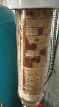

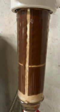

spindown filter catches what looks to me like small rust particles. When we first moved in it didn't seem to have much buildup on it, but since shocking the well it needs a flush almost daily to be kept clean. I'm thinking a cartridge filter alone would get clogged in no time.
Morton makes a whole house filtration system sold through menards that has a backflush mechanism so no filters are needed. maybe thats the move here - or at least an automated valve to flush the existing spindown. Wouldn't mind having a cartidge in addition after the spindown, just don't want to create unnecessary pressure drop.
I attached some pics here... this is 1-2 days buildup. You can see it breaks off in chunks when flushing. Water coming from the tap is mostly clear maybe a little yellow, but the catch bucket gets pretty gnarly.
