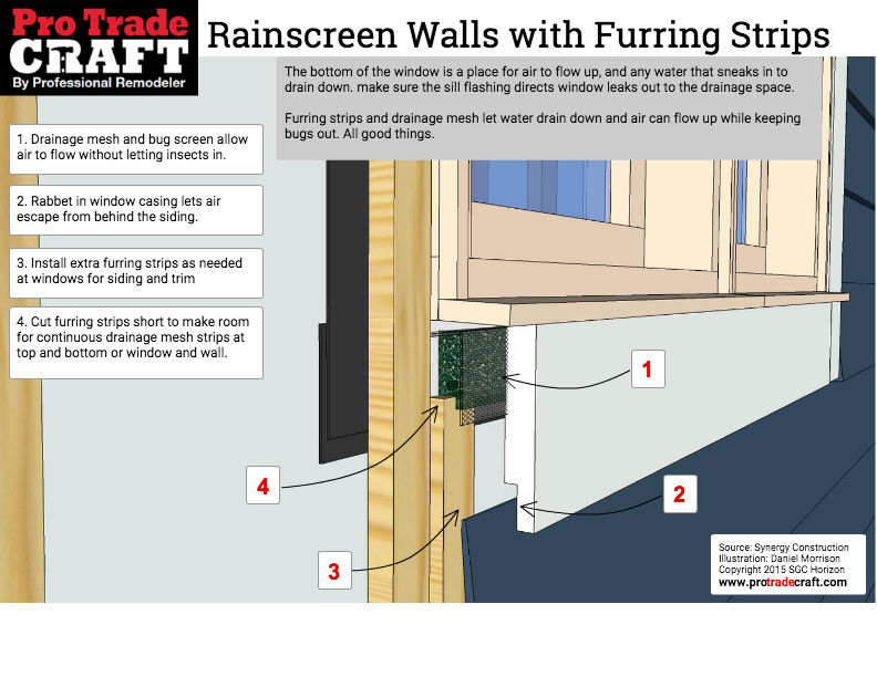

In addition to better drying for the sheathing, a rainscreen approach would also mitigate against the rough sawn large from splitting or curling, since it would dry quickly and evenly in both directions. To establish the gap you can either using 1x4 furring at every stud through-screwed to the studs with 2.5" pancake head timber screws (eg Fastenmaster HeadLok) 24" o.c. and mount the siding on the furring. Alternatively, cutting strips of 3/8" plywood as furring and using longer fasteners for the siding also works. To avoid the air spaces from becoming critter-condos, install ridge-vent mesh and bug screen between the furring at both the top and bottom of each furring bay. That still allows sufficient convection drying, but limits access to insects & rodents.
(note- if using milled furring rather than plywood strips, go with 1x4s not 1x3s- the latter tend to split, and are often corkscrewed & bent.)
Purists will also add top venting details at window trim to guarantee air-purging of moisture that gets directed there by the window flashing etc:
