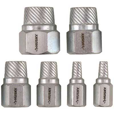

We plumbers use "nipple extractors". We typically carry a few different types. Spiral type is generally effective.
Once in a while, those copper drop ear elbows are not well secured and the whole thing comes apart and it is a disaster.
Most of the time we extract the nipple and use a brass nipple sized appropriately.

What's the difference between an internal pipe wrench and nipple extractors? It seems that the internal pipe wrench can reach in farther, which sounds like a good idea.
3,481
I've used both to remove nipples.
This one that has been cut works for broken shower arms. The full uncut version for pipe nipples.
Sometimes the easyout inside the pipe and a pipe wrench on the pipe.
I've tried these, but don't like them as well.
I have not used either, but my understanding is that: nipple extractors will only let you remove nipples, not install them, while an internal pipe wrench can do both. And nipple extractors are more robust than an internal pipe wrench, so you can apply a lot more torque without breaking the tool, compared to an internal pipe wrench.
Of course, if you're trying to break an old rusted connection where you only have access from one side, the amount of torque you can safely apply depends on how well the female side is secured (since you can't hold back), and that is hard to know ahead of time.
