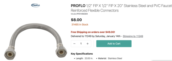

Hi I have a clawfoot tub with a faucet that is a wall mount that S-union with 1/2" male NPS end. I cannot find a 1/2" female NPS fitting for water use. I would like to use a 1/2" female fitting that could be mounted inside give the faucet more stability I looked up some of the items you mentioned and really couldn't find the right fitting. The flexible hose is the only thing we found that fits the S-union. Unfortunately that can't be mounted.
Most clawfoot tub valves have straight threads and are connected using a bent tailpiece and either gasketed or ground joint taper connection.
Your comment was the most helpful as it addressed the NPS fitting where we are having the problem. But not sure what those other pieces mean (bent tailpiece, gasketed or ground joint taper connection).
