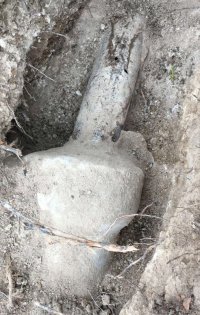

Tree roots got into my 1965-era iron sewer pipe so I'm replacing everything from the house to the street with 4" Schedule 40 PVC.
I've trenched out to the City main and it appears that the connection of the old sewer line was made with concrete.
How do I make the new connection? Chisel out the existing concrete, pull out the old cast iron pipe, insert the new PVC, and pour new concrete around it?

I think I would cut the cast iron pipe and hook your pvc directly to it (with a fernco). Then just extend their concrete collar and encase your new connection.
The most important thing when doing what your doing is to install cleanouts that extend to grade. This way when tree roots or anything happens again, you'll have access to clean the piping from the yard. No reason to bring a sewer machine into the house again.

This is the correct approach. Every utility is different.
Some utilities handle all work inside the right of way. Others require the property owner to do all the work up to the mainline. Either way, it is unlikely (but possible) you will be allowed to work directly on the sewer main, which is commonly managed by the wastewater utility.
If the connection at the mainline is structurally sound, messing with it is not usually advisable. A proper connection using an approved coupler to an existing pipe that is in good condition is often safer and more reliable than changing the connection at the main on aged pipe.
Additionally, the coupler allowable will vary from utility to utility. We require rigid couplers within the right-of-way, which means the aforementioned Fernco fitting would likely not be permissible at the location shown in your photo. However, many utilities still allow Fernco style adapters.

. Instead, I'll cut the cast iron pipe right before the right of way and connect my new PVC to the old cast iron with a flexible coupling, so no permit is needed.
I expect that tree roots got in due to a joint rather than penetrating the cast iron. Therefore I would not view this as a way to get rid of cast iron, but rather to get rid of joints.
I suggest you measure the cast iron you will connect to carefully. I would get a long-reach caliper.
These are some higher-end couplings for your underground connection.
These are good shielded couplings for underground. https://www.fernco.com/plumbing/shielded-couplings/5000-series-rc-couplings

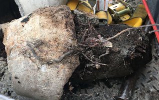

Here's an update: Excavating the city's RCP a little more, I found that there were roots wrapped completely around one section like a boa constrictor, with the concrete obviously broken. I thought that would still be my responsibility to fix, because in my city the homeowner is responsible for other things in the city's right of way (like trimming trees/plants that encroach on a sidewalk), but my wife, who is smarter than me, said I should call to double-check, so I did, and they city said that's their deal, and in less than twelve hours they completed the repair, cutting off the RCP beyond the broken part, installing a two-way 6" SDR cleanout, and connecting to my existing cast iron with a Fernco flexible coupler.
BTW, the pro plumber who bid $3350 told me in no uncertain terms that I needed a shielded coupling, but the plumbing supply house didn't have a concrete-to-plastic shielded coupling in the right size (6" ID/7.9" OD RCP to 6" ID SDR); possibly it's not manufactured by anyone. Then when the city came out, they installed a regular unshielded coupling anyway.
I got a look at the RCP they took out. In the first pic, the black matter around the wall of the pipe is tree roots, leaving only a tiny channel for wastewater. In the other pic, on the right of the concrete is what remained after the concrete was removed: roots in the shape of a pipe. Wild.

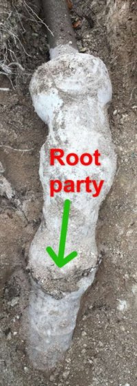

The roots were indeed not visible in the original picture. Once I excavated just a few more inches, then the roots were visible.
I didn't watch the whole process, but I think the City took out at least 4-5' of RCP.
The new cleanout is in the right of way, not on my property. When a new home is built, the builder has to install it. But if the City's pipes break and there's no cleanout, then the City installs the cleanout when they replace the pipes.

Here's the pic showing the roots wrapped around the pipe, before it was removed.
