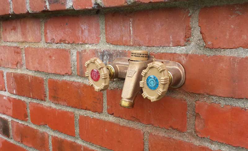

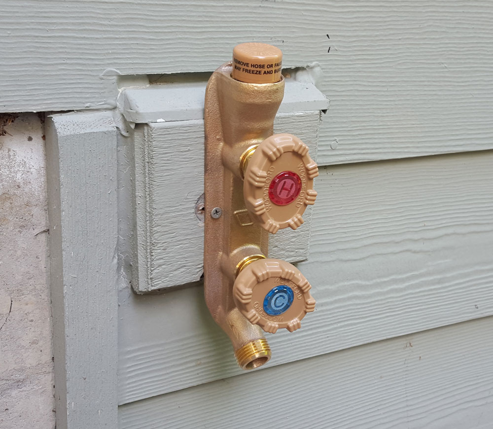

Does anyone have any good hot/cold outdoor faucet solutions they'd like to share?
I'm currently waffling between a Woodford 22 or C22 and a service sink faucet like this.
Use case is watering plants, washing dogs, and water for the kids.
I had a single-handle Moen hot/cold outdoor faucet in my last house and while it was finicky (and they discontinued it), I LOVED having warm water outside. Woodford seems like the best option in the typical frost-free hose bib space but when I called them about lead content, they were really crabby about it, giving me a spiel about how they legally aren't required to reduce the lead in their products, etc. So, because the lead content is unknown and their customer service sucks, I'm considering a service sink faucet, since there are several that are "lead free" (content under 0.25%), which, since the kids will be bathing and inevitably drinking it, is preferable.
