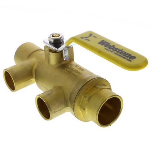

Perhaps I was too quick on the trigger. (Apologies for not reading it completely & carefully!) If the flow directions in this image are correct it's a problem.
index.php
The returns from all radiation loops (including the new basement loop) need to be tied together before the water enter the hydraulic separator, and the supplies need to come after the hydraulic separator. I didn't fully understand the squiggly bits on the system diagram until looking at the picture above. All three loops, the left, right, and basement all need to be supplied from a common point in the flow, and return to a common point.
When there is only one radiation pump you may need to install flow balancing valves to ensure the correct amount of flow on each circuit. In high flow systems this is best done with a globe valve which are not cheap, but more precisely tunable and don't wear out the way doing it with ball valves can. In smaller systems ball valves will usually work "well enough", at a lower cost but may induce a bit more pumping head.
Also, relative to reversing the flow, if both tees to a radiator are mono-flow tees it doesn't much matter, but if it's only one it does. If both tees are monoflow it reverses the flow through the radiator, but the flow is the same. If only one of each pair is monoflow reversing the flow lowers the amount of flow through the radiator:

One big problem is the boiler primary loop the tees to the secondary look can be no more that 4 pipe diameters apart center to center. I like back to back with a slight gap between them for ease of soldering. Boiler and secondary loops have only one direction. Basement and house are on to separate feeds with one pump and one return?
The hydraulic separator tees is a fully manufactured assembly built & promoted by Navien. I agree that it quite apparently violates the standard rules of thumb regarding the number of diameters of separation and that a better hydraulic separator would be beneficial in very high radiation flow systems.
Purge tees are inherently tightly spaced, and work pretty well as hydraulic separators (as long as the ball valve is fully open to induce minimal turbulance), and can speed up air purging after working on the system.
But the Navien-built manifold should be fine here.
