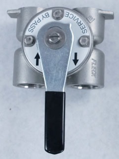

Most softener installations have a bypass valve. This can be hooked to the softener (and sold with the softener), or it can be an external 3-valve thing.
What do the connections at the back of the softener look like? Maybe consider a photo from above.
Also, look at your invoice. Any mention of a bypass?

Thanks for the quick reply... I am out of the house at the moment but will work on getting a picture from the side and top. I did see something near the inlet and outlet that says 'bypass' but when I attempted to turn by hand it would not budge but I suspect its because of the water pressure.

[Plumbing Connection:BYPASS, Stainless 1" Female NPT - 60041SS]

There it is. I have a similar 3/4 inch bypass. It takes considerable force on the lever, largely because you have not worked it for 7 years. A piece of pipe over the lever can help.
I think you turn CCW to bypass.

The photo below, shows the Fleck 60049 bypass valve which is now quite common. It is equipped with 2 handles that require turning to achieve full bypass. The photo shows it in the fully bypassed position.
jaysen
9
Bannerman, thank you for the explanation! As for the photo, this is EXACTLY what mine looks like! So, assuming I reencounter the issue, will setting to bypass on both levers allow me to have full pressure again? Does anything on the controller need to be set?
If damaged resin is the cause for the flow reduction, then bypassing the softener until the resin is replaced will make the most sense. While bypassed, since no water will be flowing through the damaged resin, then full flow of hard water will be available to home fixtures.

Currently bypassing the system to get water flowing again! it seems like while I was gone (shortly after posting and just now returning today) the flow reduction persisted - according to my daughter. I wasn't going to wait until I heard nagging from the wife, so as soon as I got home I bypassed it.
