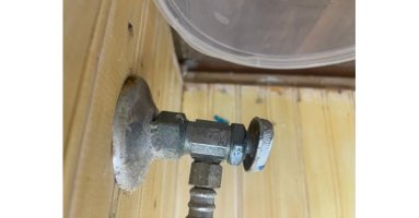

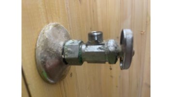

Hoping someone can tell me which angle stop I need. I get to the store and theres so many!! Also want to confirm that they are compression and not sweat. It’s a toilet supply angle stop & two for pedestal sink that we’re replacing with vanity.

compression angle stop. You can keep the nut and ferrule and swap out the valve after you turn the water off.
5/8" x 3/8" get quarter turn style...
