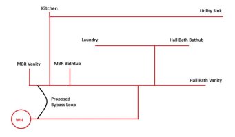

After surveying the existing plumbing, I note that the original water supply routes appear odd to me, but my plumbing experience is limited.

The way the current water supplies run, cold water comes in from the well system, forks off and runs toward the water heater, and the other fork goes out to a tee and branches off to the rest of the house from there. Pressure matters for cold too, but I don't ever have to wait for cold water, so meh.
The hot water path is what seems odd to this novice. From the water heater, it runs about ten feet and then turns at an elbow for a foot or two, then hits a tee. One branch goes off to a different bath and the laundry, and a second branch then runs back toward the WH and has three tees directly off of it -- one to the kitchen, one to the master bath tub (being replaced), and the final one to the master bath vanity. So it ends up running all the way back to literally three feet from that final termination at the master bath vanity. It takes longer to get hot water in the bathroom right above the WH than it does to get it in a room 16 feet away.
Lots of words, I know... I attached a drawing.
My guess is that running out 10' to the first tee makes it so that the distances to the terminations is all equalized (as well as it can be) to mitigate pressure drops. Not sure how the single branch with three outlets (now four after adding the laundry tub beyond the kitchen) keeps up the equalization of distance/pressure.

I have the opportunity to change the layout here. I was thinking that if you created a loop (the bent black line in the drawing) just after the WH and every tee off of that loop essentially has two feeds from each side, you could potentially alleviate some pressure drop issues. Essentially, what I will might be doing is keeping the existing path, but also adding a short circuit right from the WH to the last fixture on that second tortuous (near the MBR vanity).
On paper, this seems like it would balance the load, and the kitchen and utility sink would benefit immensely from losing about 15 feet of extra path. It's already about 30 miles just to the kitchen.
On the back of the paper, however, it might create one problem and not really fix the first one. The back of the paper might say that since the water has two paths to anywhere, it will take both paths, thereby wasting heat by filling up twice as much pipe.
Also, after reviewing the drawing, wouldn't it make sense to make another bypass from the laundry supply straight over to the left to tie in with the kitchen? I probably won't do it, but I could also bypass from the hall bathtub directly up to the utility sink
If this were electrical, I would already know that loops/bypasses in the hot are NOT cool (I have one of those cross-branch situations in this albatross house, still need to find it and break the connection, I suspect a bad DIY ceiling fan install). But this is plumbing. WHich side of the paper is wrong? Loops bad or loops good? Or is it bad in Hot but always good in cold supply lines for pressure balancing? Does water take the shortest path like electricity? Does it "mostly" take the shortest path when under pressure?
Finally, if looping is a bad idea, would it still be a good idea to bypass where I am suggesting, then CUT the part that runs off for ten feet. So, no loop, but a shorter path to most fixtures, and essentially the same length to the Hall bath and laundry supply? It comes down to "should the feed into a manifold be in the middle of the manifold, or is it OK to have it feed in from one end? Feeding in the middle seems more balanced, but only if it is very short. It's OK to tell me I am over-thinking it. I just want to know.

OK, so if the two paths in a loop are equal, it will waste hot water by filling both ends of the loop, but if one is 3 feet long and one is 27 feet long, then 90% of the water will take the short path? Even if it's not linear (physics hates linear curves, lol), is that still the general idea? I am not really trying to resolve a pressure issue, just the annoying wait for hot water for a fixture that is practically above the WH. I wouldn't even fix that at all, except that I am cutting the supplies anyway, and PEX is really just too easy. The bypass loop is literally two feet long.
So, would YOU do it? That drawing is somewhat to scale, except that the kitchen and utility sink lines are about twice longer than they are in the image. I think I should install the bypass, but cut it between the first tee after the WH and the MBR bath. The hall bath and laundry fixtures don't really need to be shortened, nor would this make that shorter anyway. I just answered my own question. LOL, never mind. Sometimes you just gotta talk through things a bit. Sheesh.

OK, I think this is what I will do. This way, there are no loops and the distances to each fixture are minimized. Please give me advice or other feedback if need be. Discussion helps others too.

It is OK to feed from one end.
I think you are asking if it is OK to have paths in parallel. I would presume so, since I have not read to the contrary. With parallel paths, water will go both ways. It would be like resistors in parallel in an electronic circuit.... So with 1 ohm in parallel with a 2 ohm resistor, there will be twice the current flow thru the 1 ohm.
Dead legs in supply plumbing are not allowed, because they are places for bacteria to hide out.
