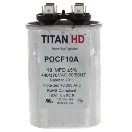

However, my cap has no label on it. I see that the motor label says "CAP 10.00/370". Does that give me a clue? Thanks

"CAP 10.00/370"
Yes. 10 μF 370 volt. Common value. They come in different shapes. If you have an electric motor shop in your area, I would check there.
(Edit: replaced mf, which is the old way to abbreviate microfarad, with μF) https://www.dictionary.com/browse/microfarad
A 10 millifarad 370 volt capacitor would be very far from common.
pF was called mmf or mmF in the old days.

Is that 10 mf as in Milli Farad, or 10 μf as in Micro Farad? It seems like most sellers online is selling the 10 Micro Farad unit.

A 10 milli Farad (10,000 uF) 370 VAC capacitor would be truly HUGE. (Such capacitors exist, but would never be used in a residential air handler's AC motor startup circuit.)

All right, I have replaced the Capacitor, and the issue still remain, i.e. thermostat intermittently shut off. Actually, after the blower start to run, thermostat shut off at about 1 minute 30 seconds. After 2 minutes of blank, thermostat comes back again, initialize, then blower stop. Within 30 seconds, the blower would start again, and whole cycle repeat.
