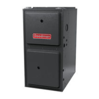

I have a Goodman furnace GMES960805CU, 96%. The green LED light is steady on. The blower will randomly turn on and stay on for awhile, if I unplug the thermostat the blower turns off. Plug the therm back in and the display is still off but the blower will randomly turn on, no heat.
Any ideas whats going on here?
