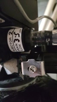

I got the Fkeck 5600sxt installed now but it seems the injector is different than what a lot of the standard programming help references.
Can I get some help figuring out how to set this up based on the injector pictured below and my water report from the original post?
I though I had the programming figured out but later realized the injector was different than what most people online talk about.

Can I get a quick verification of below?
With the injector pictured above. If I want to use 10lbs of salt per cubic foot of resin for my system. (2 cubic foot resin)
I will set the BF to only 3 minute.
Is that correct?
I still don’t know how that relates to the brine draw portion though.

No, no.
You need your DMLP number-- look for a label near the brine line. That may be a mylar label silver on black, and it might say 0.5. That is important to select the BF number. The thread I linked to had a hand-written value of 1.0, which is not common.
On the injector, I would have preferred a #00 or #0.
#00 Injector - Violet #I would probably go there, but maybe not with 10 lb/cuft of salt. It would increase the time for a regen.
#0 Injector - Red #good
#1 Injector - White #not bad
You have a
#2 Injector - Blue. I think that is bigger than good.
If you got a #00 instead, you would raise BD to a higher number. If you go with 10 lb/sqft, then BD time would be higher than with 6 lb/sqft.
10 lb/cuft is more salt than most choose. I would start with 8 and see how that is for you. The other thread is starting with 6 to use less salt while getting pretty good softening.

Thanks.
10 lb/cuff was just an example to see if I was correct or not.
I found a label on the brine line area.
It says .5 GPM and 1.5PBS of salt per minute.
I Don’t know what that means.

If you switch to a #00 injector, I would change BD to 105. With a #0 injector, I would make BD=70.
System info (not programmed)
salt lb/cuft = 7.5 ; A choice ( efficiency vs capacity)
BLFC = 0.5 ; Brine Refill rate GPM
cubic ft resin = 2 ; ft3 resin = (nominal grains)/32,000
Compensated hardness = 23 ; including any compensation
People = 4 ; gallons affects reserve calc
Estimated gal/day = 240 ; 60 gal per person typical calc
Estimated days/regen = 8.35 ; Computed days including reserve

Thanks a bunch for that.
I have seen you post lists like this a bunch for people.
I guess I wasn’t understanding the role of the injector #2 thing in relation to BF and BD.
You mention recommendations for #00 and #0 injectors. If I stay with the #2 should the BD stay at 60?
I still don’t really understand what the injector is doing to the settings.

Leaving it at 60 is the normal thing, but I would consider dropping that to 45 minutes. The injector sucks the brine out in some amount of time, and for you I estimate 11.6 minutes. Usually you want the BD time to be maybe 3.5x or 4x that time.
Injector is not involved in the BF number.

Perfect. Thank you very much.
Just before you sent this reply I found a post that mentioned the 4x time. But I still didn’t understand whether the injector was involved in BF.
Now I get it.
