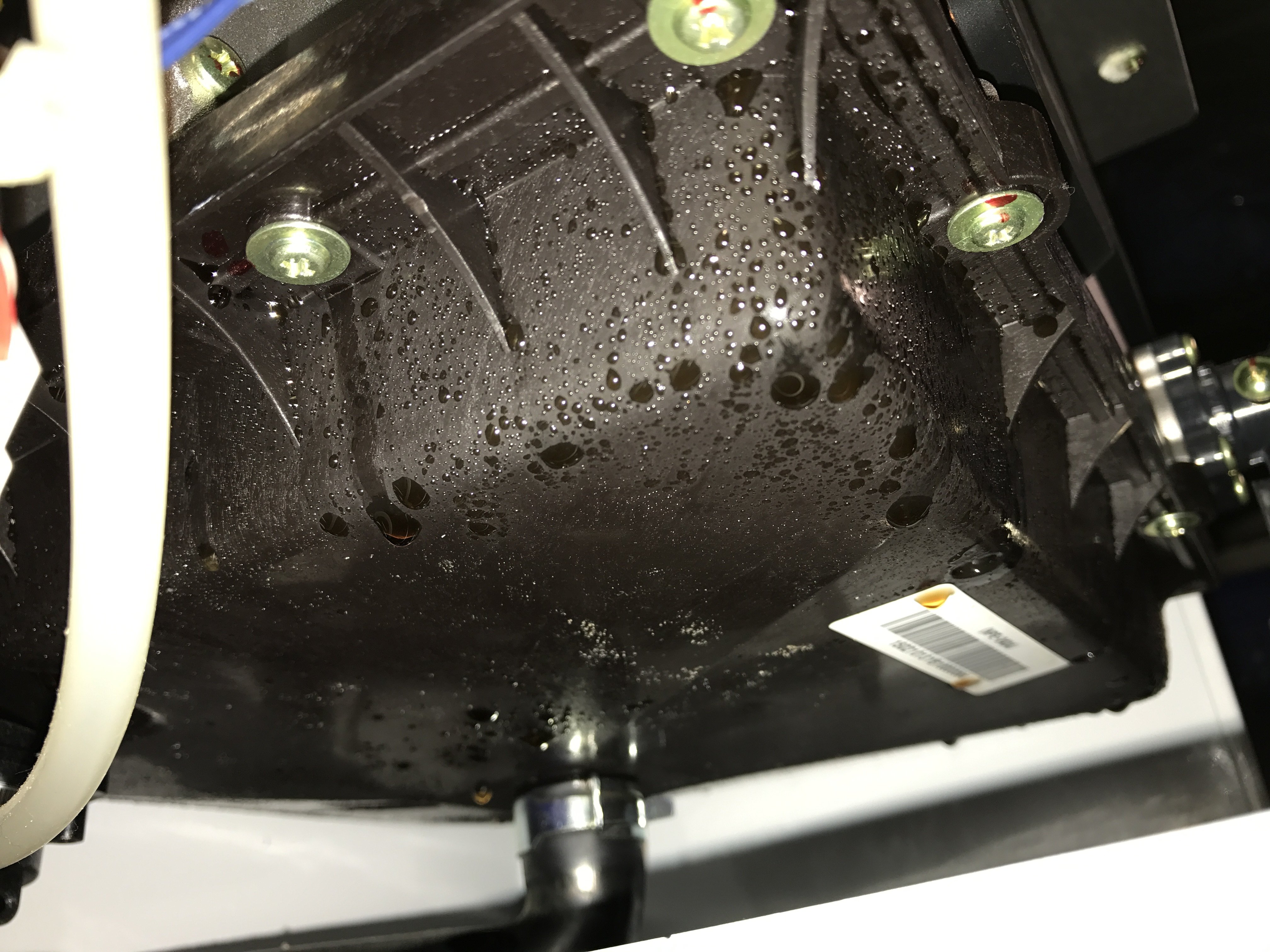

When you had the cover open, did you happen to see any oily residue, discoloration on the main control board, or rust around the rubbery gasket on the exhaust port?
If yes, the lifecycle of that unit is probably limited. Those are all symptoms of exhaust leaks internal to the cabinet in the water-tube heat exchanger type Navien models (boilers, combi-boilers, and water heaters alike), and even warranty-replacement heat exchangers are leaking at the gasket between the burn chamber & heat exchanger (right above the sight glass & igniter). Hopefully yours is of a vintage with better quality control &/or design details/materials and doesn't have either of those issues.
^Residue on bottom side of the heat exchanger assembly. That is not a water leak or water condensation!^
From a safety point of view as long as the gasket around the main cabinet cover is in good shape the exhaust won't be leaking into the house, since the cabinet itself is at negative pressure when operating (it's sucking gases in, not blowing out), whereas the burner & heat exchanger are at positive pressure relative to the air in the cabinet.
When exhaust is leaking internally it becomes mixed with the combustion air, leading to higher moisture content & lower oxygen content in the combustion air than the system is designed for, and it will shorten the product life as well as lowering the net efficiency. This is why intake air and exhaust venting ports outside the building envelope need to be adequately spaced to keep the warranty valid (and how Navien can duck at least some of the warranty claims even when the main problem is leakage & cross contamination inside the cabinet.)

My Navien CH240 Combi Boiler was giving me a 10E(010E) error code, it would start after a while but with a knocking & swishing sound in the heat exchanger, i did what everybody else does, i went online, i read all the posts from other people with my boiler, did everything they suggested, i checked almost everything, cleaned all the filters, checked every radiator for trapped air, checked all the pipes & hoses 100 times, after 5 hours i was ready to throw in the towel & call the pros, but there was 1 hose i didn't thoroughly inspect, "the big hose under the heat exchanger"... I removed the hose clamp on the bottom & twisted it loose from the heat exchanger & it was completely clogged with rusted pieces, i stuck my pinky in the heat exchanger to loosen it but it was packed solid so i stuck a wire hanger in & all of it came gushing down, there was at least a pint or more of condensate trapped in the heat exchanger. Needless to say my boiler is working perfectly again.
4 Years later and this forum is still saving lives. I made an account just to say Thank You EddieRiv! I had the exact same issue as you with the exact same process except it was 3 days of diagnosing for me with 100$ wasted in parts and overnight shipping (changed the aps and air vent valve). I also had the gurgling and swooshing, and the code only came up when the heat was called, the DHW worked just fine. research showed heating side used more pressure and needed more condensing than the dhw which is why it only threw a code when heat was called. Thank you again to everyone and specially EddieRiv for posting their problem and solution, its still helping dads all over the country like myself, im a hero to my wife and kids once again!
Wonder what isn't stainless steel. Both hx supposed to be stainless.
