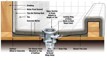

You really need to know how the pan was done.
If it was with something like Kerdi, thinset would have been used to adhere the Kerdi membrane to the Kerdi drain. Maybe the overlap wasn't done properly.
If it was a PVC liner, maybe the liner is not clamped properly at the drain.
Or you could have a hole in the Kerdi or PVC liner
Or a liner/membrane was never used, thinking that the tile was waterproof.
Here's a picture of how a PVC liner would have been installed. The liner is clamped by the drain during installation and before tiling.0989c96013671a66d5d0c66fdf845043-1386581231.jpg
Btw, the leak test that your plumber did should have been done before the tile was installed by whoever built the shower. That would have been the time to detect a leak and remediate.
