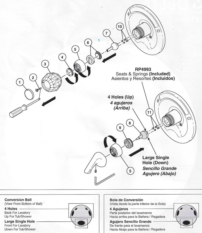

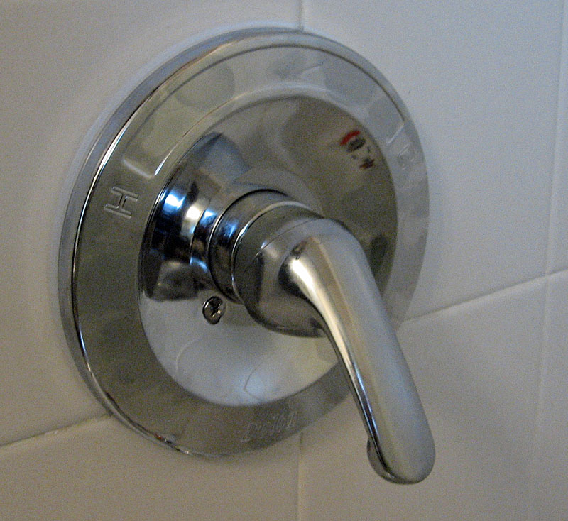

We lost the escutcheon that goes with our shower faucet during renovation, and I'm having a hell of time finding a replacement. There's no brand logo to help identify it. The faucet handle measures 1 3/4" wide, so I need an escutcheon to fit but turns out shopping by interior hole dimension is challenging- most websites don't list that measurement. Any ideas or suggestions would be most appreciated.
Delta with the lever handle
This one had the crystal knob.
3,481

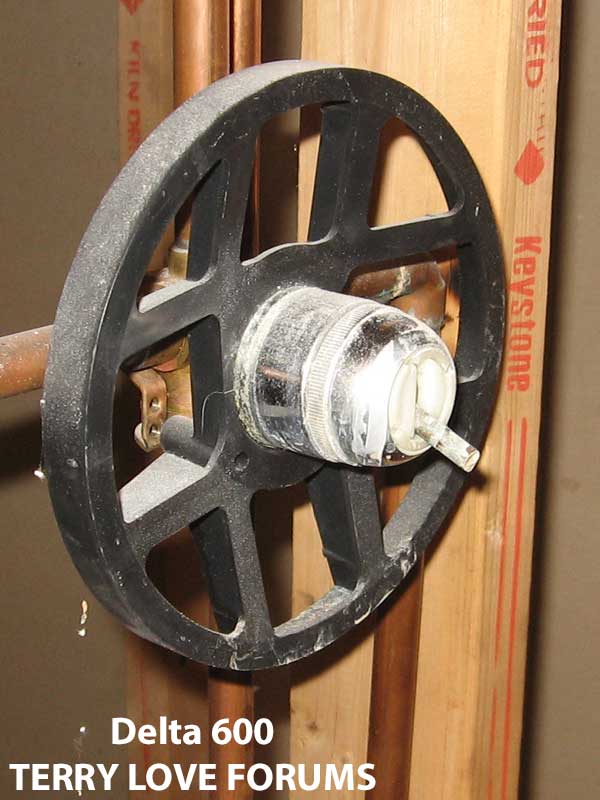

Delta 600
That should have been replaced while the wall was open. It's not too late to change it though.
Regardless, the hole is too small and you have no way to screw the wall plate on.

Here is the O&M sheet from Delta. They do have complete remodel kits # RP54870 available in chrome, brushed (St. Steel)and bronze.
