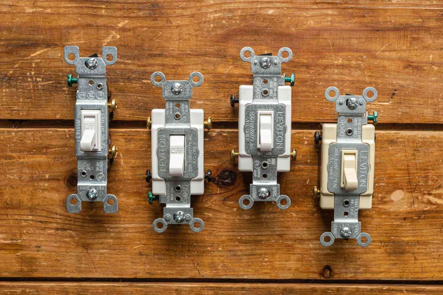

Instead of switches with dimmer could do this with Alexa or eco dot. Then you don't have the possibility of a back feed into the dimmer. Why would u think a person wouldn't touch the mood lighting switch while visiting the toilet. Here just some of the smart switches look.at the 4 & 5 way
