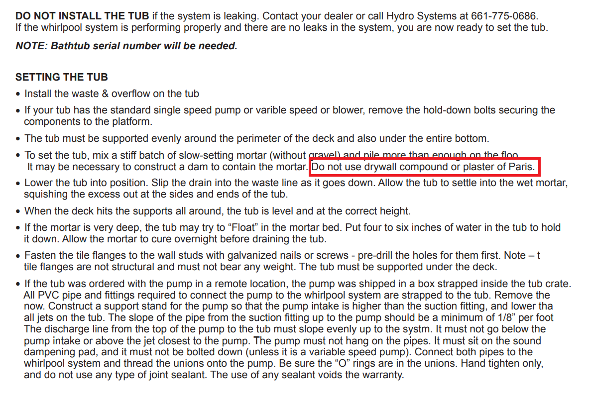

I have a HydroSystems Sydney bathtub and it clearly states in the instructions that only mortar is to be used.
Click on the pic for the full manual.
