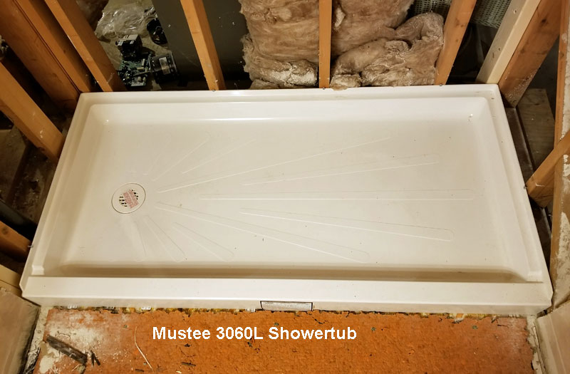

I have only recently heard about this and am confused about a couple of things. I am installing a fiberglass tub for a neighbor and when you look at the bottom it has a large piece of what I call Chip board (chips of wood glued and pressed together) and the legs are 4 x 4 wood. When I've stood in the tub, there is no flex whatsoever. I replaced the floor with 3/4" plywood and plan to lay vinyl linoleum.
1. Why would this be necessary?
2. With the majority of the wood not covered by fiberglass wouldn't it soak up moisture from the mortar, thus weakening it to some degree?
3. If it was absolutely necessary to support the bottom, even with the chip board wouldn't using a 4" or so wide board down the center of the tub be enough if anything was needed at all?
No instructions came with the tub or surround (both fiberglass) and not in any boxes either... Gawd I so enjoy remodeling mobile homes! NOT! lol

Many older tubs were made of cast iron (and many still are). A CI tub is strong enough to not worry about flex, but even one of those can benefit from something under it if the floor is not both flat and level. No tub is designed to be completely supported by hanging from the rim. A few tubs have a structure that is fully supportive and works fine IF the floor is both flat and level. If your tub is not set level, you'll have problems with moisture running where you don't want it.
Any moisture used in mortar or plaster is chemically incorporated into the mix when it cures...there is NO water left. After that, the only way moisture gets under there is if something fails or you play water games in the bathroom. To help keep the wood dry while the stuff cures, a sheet of plastic works fine.

NO tubs are designed to be held up by their rims on the ledgers...the ledgers are to hold the edges in case you sit on them and help hold things in place while the mortar bed sets up. The only tubs that don't need it are those with an engineered flat bottom that is already fully supported, or a cast iron one, and then, only if all of its feet are sitting evenly on the floor. Water weighs about 8#/gallon. Add say 30 gallons (and some can hold more than twice that much) and an average American and you've got easily over 400# hanging on that 1/4" thick lip of plastic...NOT a great idea. The tub WILL flex. They're fairly resilient, but in the process, it will stress the drain line and possibly squeak as it rubs against anything it touches.
I don't see the issue - this is not a corner to cut. Mortar is cheap AND it lets you get the tub perfectly level.
