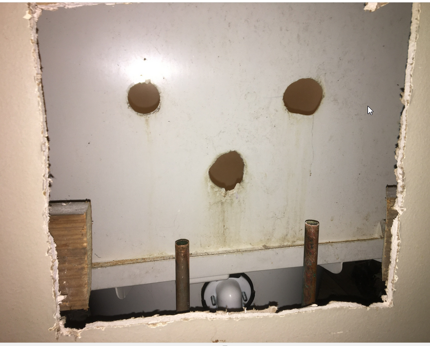

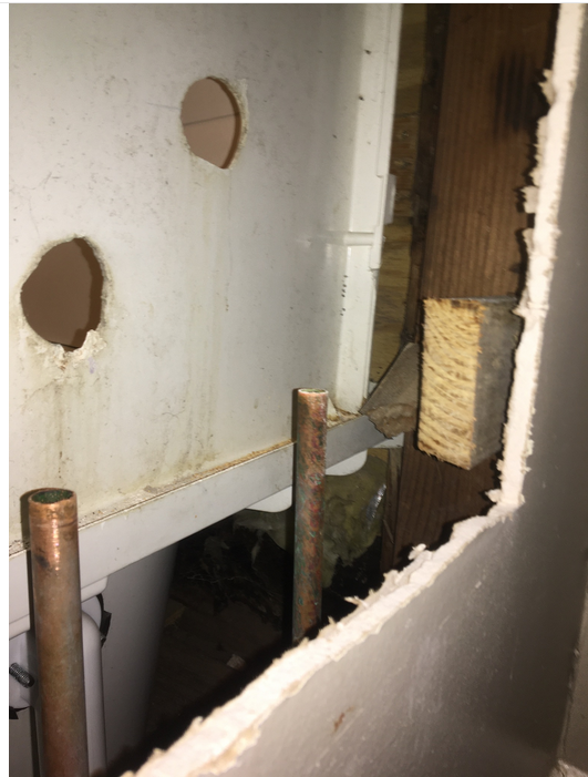

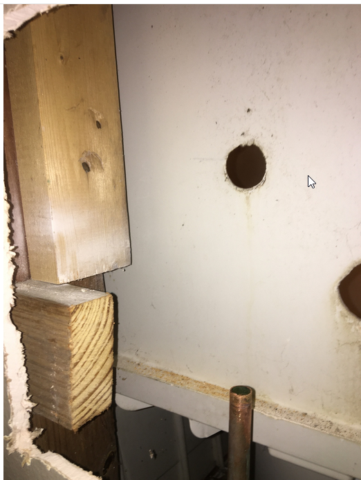

Here's what I found when I opened up the back. There is a 2x4 running slightly below the fixture that is mounted to something solid, and they had laid a loose piece of 2x4 on top of that solid 2x4, I guess to try and provide some resistance when pushing on the pipes. So I guess I will screw a new piece of 2x4 (or stack a couple) into the mounted 2x4, and butt it up to the back of whatever I put in there, unless that wouldn't suffice.
It seems like a lot of people (most?) go to a single handle... is there a particular reason for that? Is it for looks, or is it also less maintenance or something? Is there a big price difference between a one handle setup, and the style that I have?

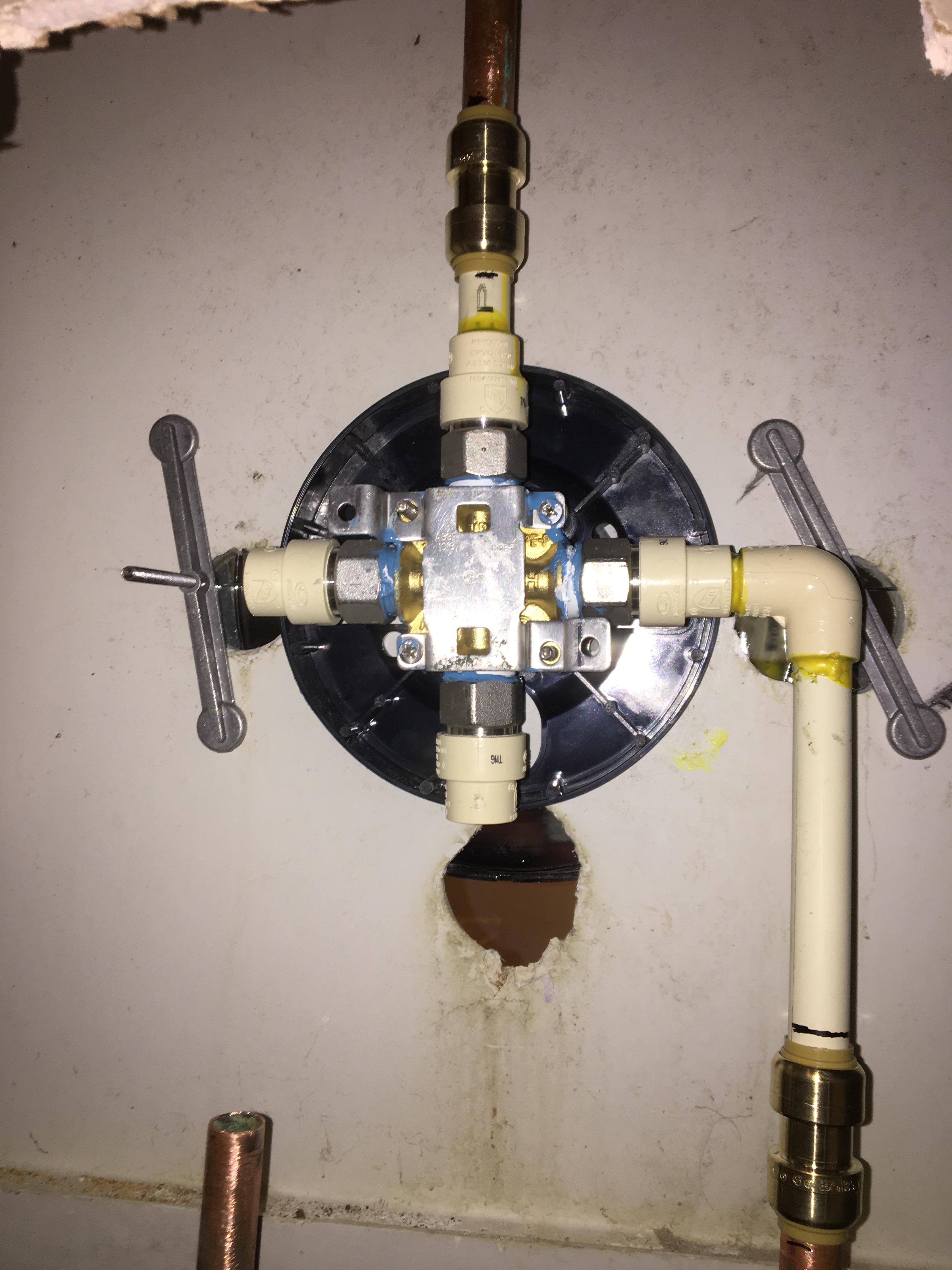

Thanks JohnCT. I'll have to save the soldering for another day, as I've never done it before. I need to stop putting off learning the basics though, because these sharkbites add a lot of cost to these projects.
I got threaded brass nipples to use for the spout. Using a brass coupler at the valve with a brass nipple into a brass 90, and another nipple out to the spout.
I had to cut the solid 2x4 out to get better access to the pipes, and here is what i have now, with a couple of side shots. Not entirely sure how I'm going to mount it yet, but I guess I will figure it out as I go. Maybe I can toenail in a 2x4 between the joists, but put it closer to the tub than the one I cut out, and screw the valve into it. Then maybe toenail a 2nd 2x4 below that one for the tub spout pipe.

The secret to making a S Bite last is to prep the pipe as much as if you were going to sweat it - perfectly clean and smooth paying particular attention to cleaning the burr from the cut - you don't want to nick the inside O ring when pushing the SB on and a smooth surface ensures the Bite will seal now and for a long time.

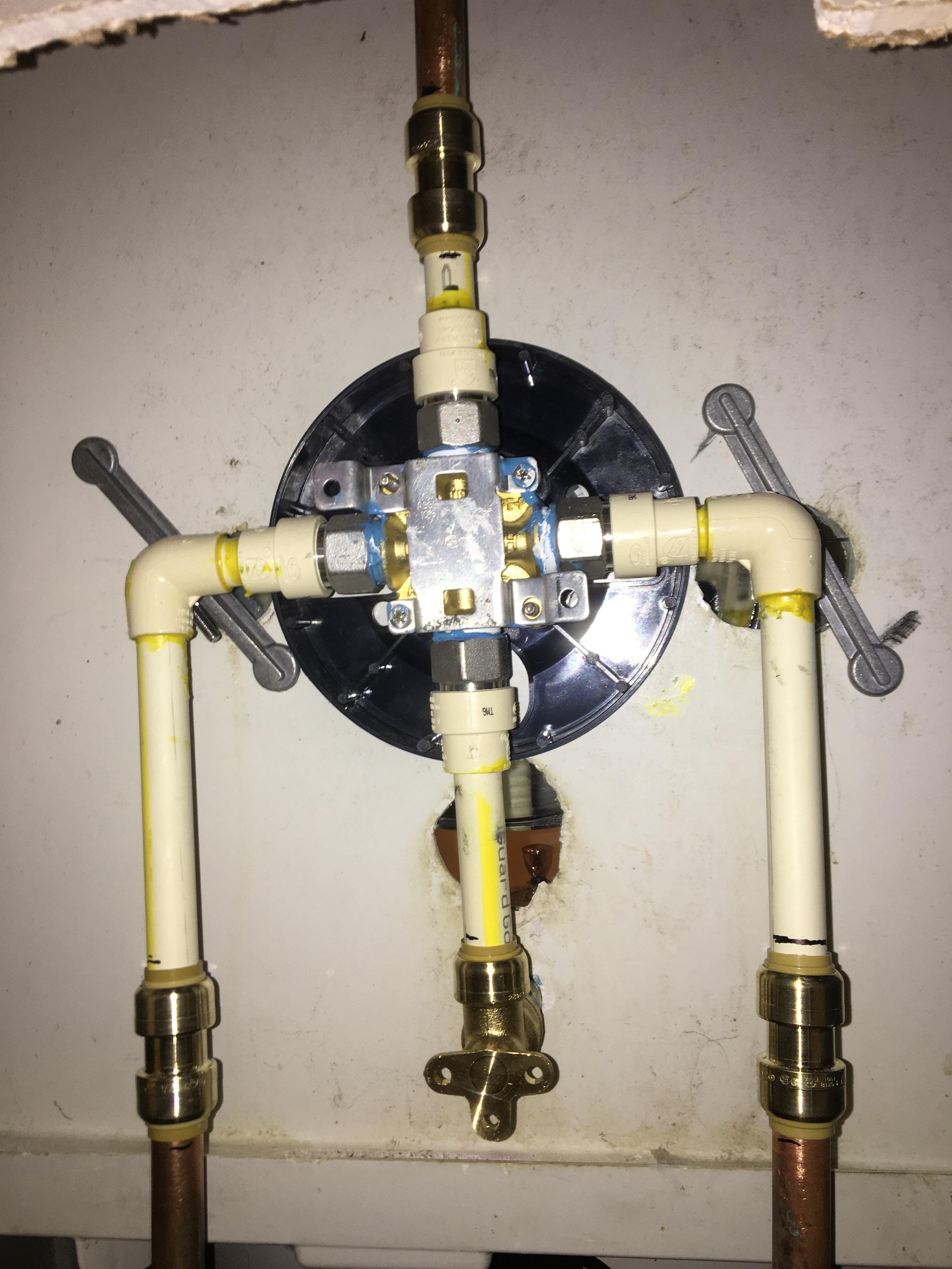

Here's where I'm at with it. Tub line is going to be cpvc into a drop ear 90, and then a 5" brass nipple into the tub. Let me know if anyone sees anything amiss. I'm going to screw in a 2x4 after I make the connections, and attach the valve to it.

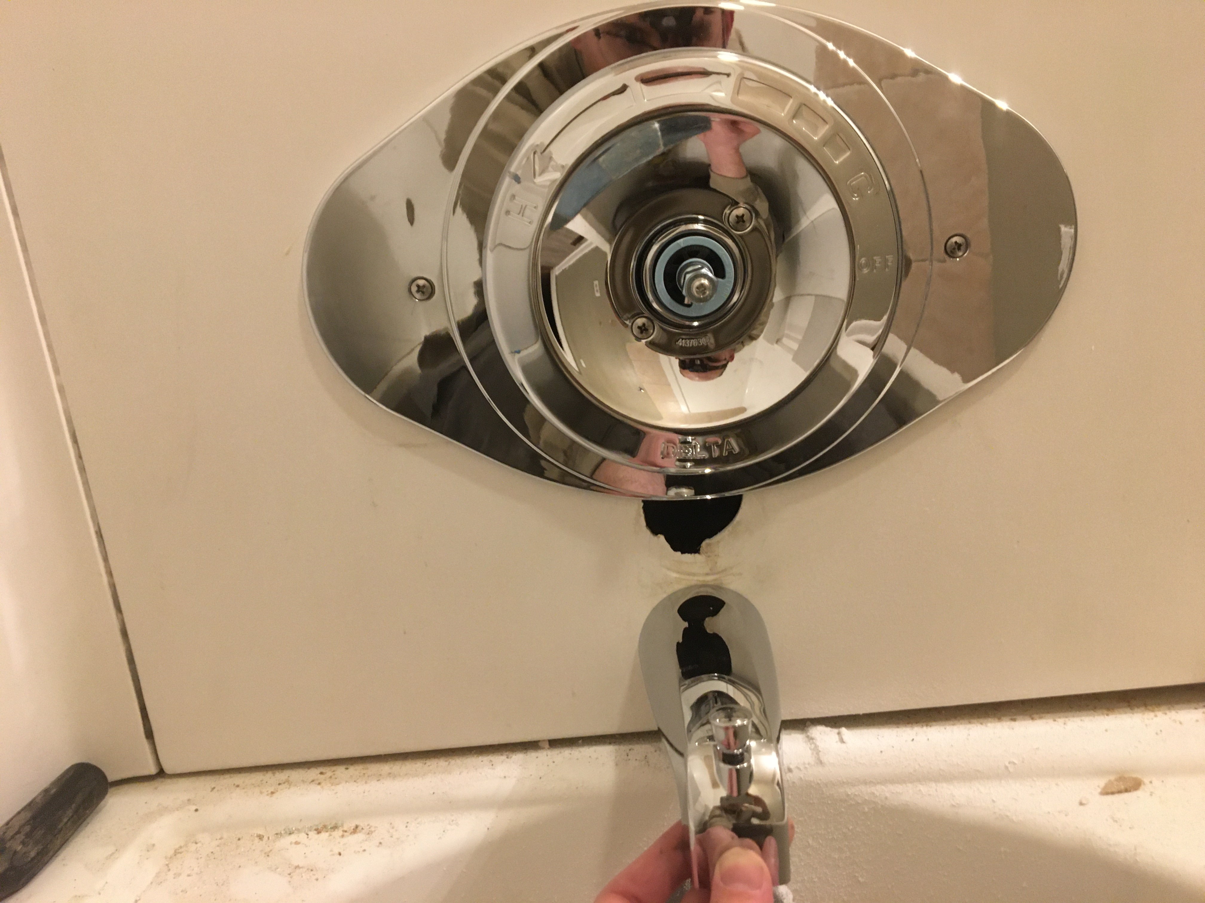

The remodel plate overlaps the existing tub spout, and since adjusting the tub spout just enough to clear it would leave a gap around the spout, I'm thinking about just dropping it a couple of inches so there is no gap around the spout, and then cover up the hole under the remodel cover. Anyone have any ideas how best to do that?

What concerns me is the prep of the pipe - it looks like it was done with 80 grit or larger paper. The pipe should be smooth almost like glass before running the SBs on. You need 200 followed by steel wool to get that smooth where you can't feel any defects with your finger nail. Also check the stab depth of that CPVC pipe into the Bite - it looks a bit short.
As far as the hole, I'd check with some local bathroom remodelers and see if they have any scrap sections of enclosure panel you can get. If you can, just bond it from behind.

Ah, yeah I used rough sandpaper on it... I'll get some fine paper to use on it, and will monitor the others. I'm going to leave an access panel in place, so it will be easy to check. My mark was a little long on that CPVC, so it should be ok.
I'll keep your idea in mind on the hole, and may use an epoxy repair kit for now.

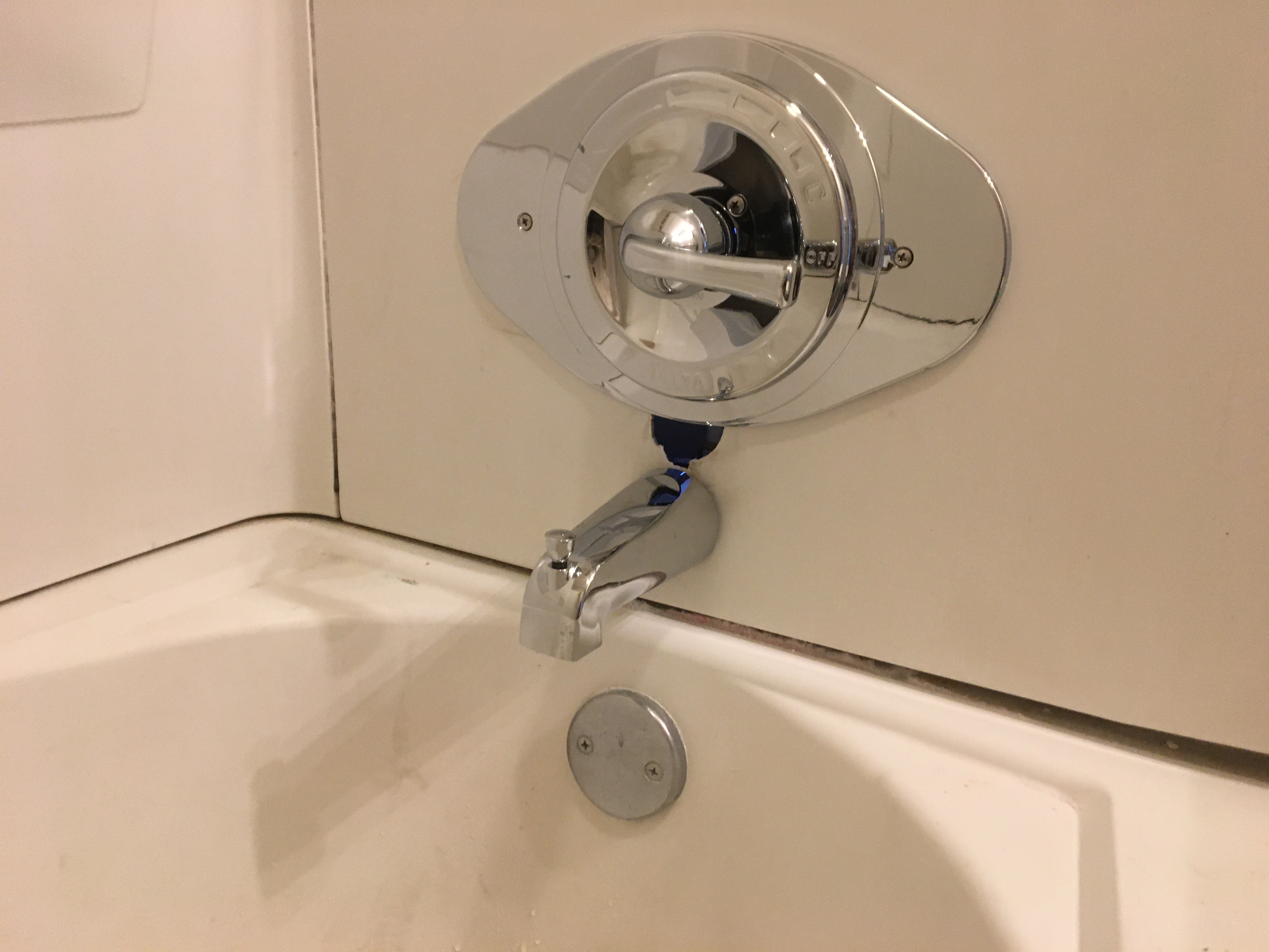

Well, I got it finished.. Still have to mount it to some blocking, but I had zero leaks when I tested everything.
I'll attach a parts list if anyone is curious. In total, it cost $310 to convert from 3 handle to 1. I'm really curious what a quote from a plumber would have been, to compare against my more expensive parts list (sharkbites and $40 worth of drill bits).
It was pretty daunting in the beginning, especially since I have never worked on any type of shower valve. I was heavily considering calling a plumber at times, but obviously glad I didn't now. Yes it would have been nice to have avoided all that stress/work, but now I know exactly what's going on behind the wall, whereas before I really had no clue.
