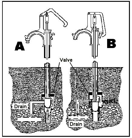

For the outside faucet, an alternative is the yard hydrant. That has the valve below the frost line, and when the faucet is turned off, it drains into the dirt or gravel .... you would not need to go crazy making a drain pit if your soil is at all porous.
For a shower you would need to make provision to blow the water out with compressed air before the freezing season.
