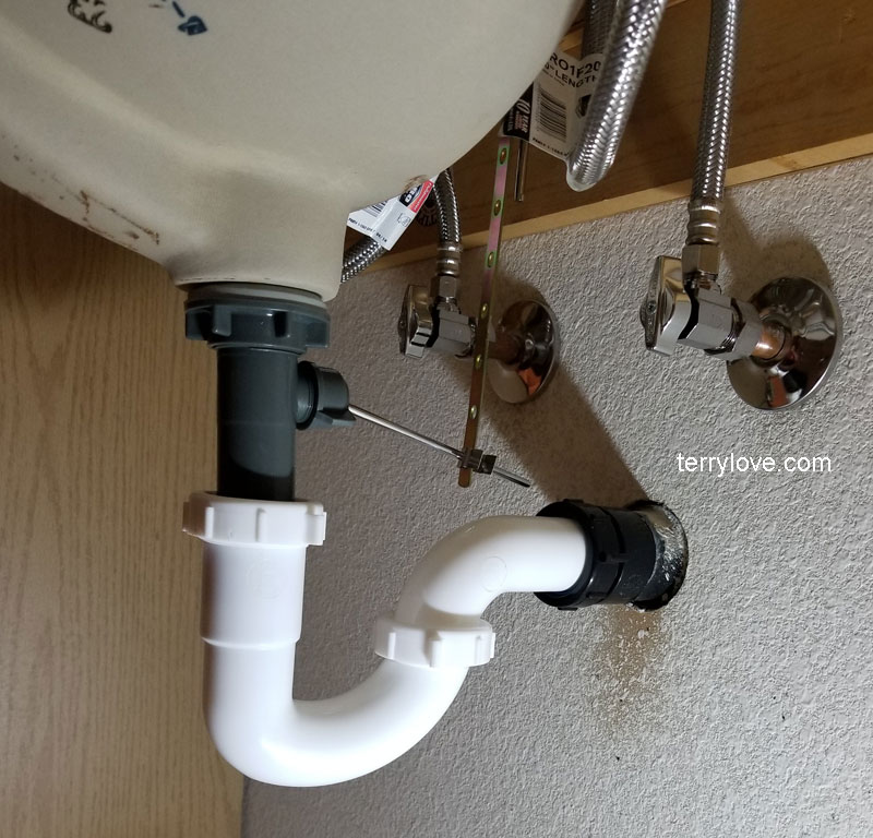

So I have a bathroom sink I just installed with new tile countertop etc. Standard [strikeout]Kohler[/strikeout] Glacier Bay sink from Home Depot.
Original glued in pipe had a 45 bend in it which was not allowing the new sink to align with it.
Cut all of that off and installed new plumbing from wall out.
I put the drain in, but found it was leaking at the gasket around the tail piece.
I took everything apart and found the rubber gasket is the problem. It will not mate properly with the
hole of the sink. The nut doesn't push it into place either. It squishes it sideways which I guess is why
it leaked to begin with. It's like it's stretched by the pipe a hair to big for the hole in the sink.
I tried to put the gasket on first.
The gasket fits without the pipe perfectly, but then the pipe will not push through the hole and nor will it screw through either. I tried to 30 minutes to force it and all I got was a sore hand and back.
Any ideas of what to try next?

OK. Photo attached. The seal as you can see is not sitting right in the hole. Also, it's a Glacier Bay sink not Kohler.
The tail pipe is a normal off the shelf part from Home Depot. The plastic kind that is a step below the chromed one they sell if that makes sense.

I have had issues with the holes in lavs sometimes not being round and having a poor fit with a drain washer like that.
Does it leak? And if so where? Sometimes water will find it's way down the threads.

Yep. Leaking around the seal. That gap seems to be the leak point. It doesn't leak immediately, but it starts a drip-drip-drip
a few moments after the water is shut off. Sounds like water is getting into the plumbers putty and as you said running the threads and past the seal.
I tried to put that rubber against the lav bottom and push the pipe through or screw it through as I said originally but it didn't work. The seal is a hair smaller than the pipe and too tight to let it pass.
Any ideas what to try next? This is literally the only thing standing between using this lav.

OK. Let me ask this before I go on. Is this gasket supposed to go inside the opening or just soft seal against it?
If it is supposed to go into the hole then that is something wrong with the sink opening being too small to accept the seal plus the pipe passing through.
Otherwise, I am just doing something wrong with how I've set the top and bottom.
Do you see the gasket under the lavatory on Terry's picture on #2? Gasket hits the bottom of the lav/sink.
See that gap? If you rotate the drain 180 degrees, and the gap stays where it is, the sink is bad. If the gap rotates with the drain, the drain is bad. I am betting on the sink.

I've had sinks like this before. This sink could be defective indeed.
Can you tighten the big nut more?
If not, grind the opening with a masonry blade. Go easy with the grinder.
The second option is to go back to the store and get another sink.

Got it fixed!
I got a pair of good channel lock pliers which could actually grip the nut better than my old "genuine" vice grip pliers.
The rubber was forced into place by giving about 3 turns more than I could make before.
Put the stopper in an filled the sink. No more leak. It held water for 5 minutes without draining.
I may still put a bead of clear 100% silicone around the drain inside as a good measure.
BTW, I think the other reason why it was leaking before is that I have to slightly pull on the tail slightly sideways
to mate it up with the trap; it's fractions of an inch off being straight.
That small bit of torque mixed with the seal not being seated right obviously opened enough gap to let water pass.
With the rubber gasket fully seated that seems to have sealed any gaps now.
