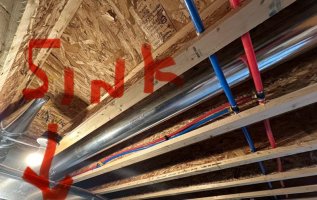

Hi everyone.
First time poster but have learned a lot looking at this forum throughout the years so thanks.
I am looking to install a basic utility sink in my basement. I have decided on the location based on the very close proximity to both a drain and pex lines. I will provide a couple pics because I do have a couple questions if possible.
The large line has multiple lines feeding into it as seen in the picture. There is a clean out on this drain and it eventually goes into the concrete floor never to be seen again ha.
First question is of course, is this line a good candidate to add a sanitary tee in to drain the utility sink? And would the sink drain need to be above or below the clean out? If above, I would have to cut out the current clean out and buy a new one it would seem?
The other main question is as seen in the other picture, I have a hot and cold set of larger main line pex running down the center of the home through the joists and the smaller set already tee’ing off of those. That smaller set has a random set of crimps I’m not sure why. Would I tee again off of those smaller half inch pex and run them down the foundation wall or would I tee off the main lines to my new sink?
Lastly, would I need to studer vent or something next to my sink?
Thank you folks for any help you can provide.

Looks like adding under the clean out could work. Yes you would need a vent.

Is it okay to have the sink drain below the clean out? That does seem to be the easiest location since the clean out is up high.

Yeah I’m not sure why he asked a question in my thread. Anyway, do you guys think I should Tee into that drain below the clean out? As shown in my picture.
And then put a studer vent sticking up out of a Tee between the drain and the sink?

You could just put a santee in that stack and then stub out through the wall installing a aav "studor vent " under sink . I think thats what you were saying. I dont study WI code a quick check it looks like there might be an issue with AAV you might refer to your code.

I can’t stub out through that wall. It’s the poured basement foundation. I believe that one pipe going into the wall is my garage floor drain.
So if an aav is against WI code, what other option would I have for venting?

I thought sink was on other side of wall, its even easier just put that san tee and your studor vent since you brought up the studor vent I assume you know its legal or not , some people dont care if its legal. I tried looking and saw some controversy about AAV being legal or not in WI so Id recomend checking localy with building department

You got confused because that other guy randomly asked a question in this thread and his sink was on the other side of a wall.
On mine just see the pictures I put in my first post and I’m just putting the sink next to that stack drain. And planning on just tee’ing off the pex which runs right above the wall and running the pex right down the wall to the sink.
I’ll research the AAV. But if it works it works. Easy to change if I ever needed to in the future.

I realize you arent going through the wall as you see in my post 11
your plan works (AAV) it just might not be legal Wisconson has thier own code and I didnt readily find an answer

Yeah I’ve been looking too and don’t see anything. The house is only a few years old and I know there are already a couple vents going up through the roof. Single story home. Wonder if that drain stack in my pic is already vented to the top?

As far as performance My opinion is it should be ok . My only concern was code and I didnt want to try to figure out your code there are 2 major codes in the country IPC and UPC one allows the other dosent but some how we manage to have relatively good working plumbing systems Ill always feel a real vent is superior but at what cost ? is it worth it ? tearing a house apart drywall patch more pipe ,fittings, holes to drill. vs throw a cheater vent on and forget about it. My opinion is if walls are open and acessable run a real vent every time!
